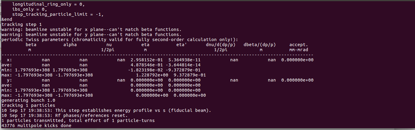

Thanks for the reply. I tried the scripts and found that when setting the "edge1_effects=2" and "edge2_effects=2" in the CSBEND element, the calculated tunes and chromaticities agree well with the tracking datas, while when I set the "edge1_effects=1" and "edge2_effects=1" in the CSBEND element, it got the same tunes and chromaticities in Twiss calculation but different tracking datas. This explains well why I should use "edge1_effects=2" and "edge2_effects=2". The chromaticity has a little difference with AT and MAD-X of about 0.1, and this difference might comes from the different calculation methods for the edge field of these softwares. Could I ignore this small difference in the chromaticity calculation?
Sorry I still have another question that when I set the "edge1_effects=0" and "edge2_effects=0" in the CSBEND element, there comes a failure in the Twiss parameter calculation, as the attached picture shows. Why doesn't the 0 act as the way to turn off the edge effect, as the manual says.
The lattice with the "edge1_effects=0" and "edge2_effects=0" and the program are attached. Could you help me see this problem? Thank you very much.

- Posts: 2063
Re: About the edge_effects option in the CSBEND element
Siwei,
I think the difference between AT and elegant at this point is pretty small. In particular, if you put in a 3D field map and did tracking with that, you'd probably get an answer that was not the same as either of those results, but close to both. (It's worth trying that. You can use the BRAT element in elegant to do that.)
As for the undefined lattice functions when you set EDGE1_EFFECTS=0 and EDGE2_EFFECTS=0: Your lattice has a rectangular dipole with a bending radius of about 2.2 m. This gives significant vertical focusing at the two ends with a focal length (rho/tan(theta/2)) of 5.2 m. When you set EDGE1_EFFECTS=0 and EDGE2_EFFECTS=0, the magnet is converted to a sector dipole, which has all that focusing in the horizontal plane instead. The result is that both planes are unstable because the quadrupoles are designed to deal with the vertical end focusing and not horizontal sector focusing.
