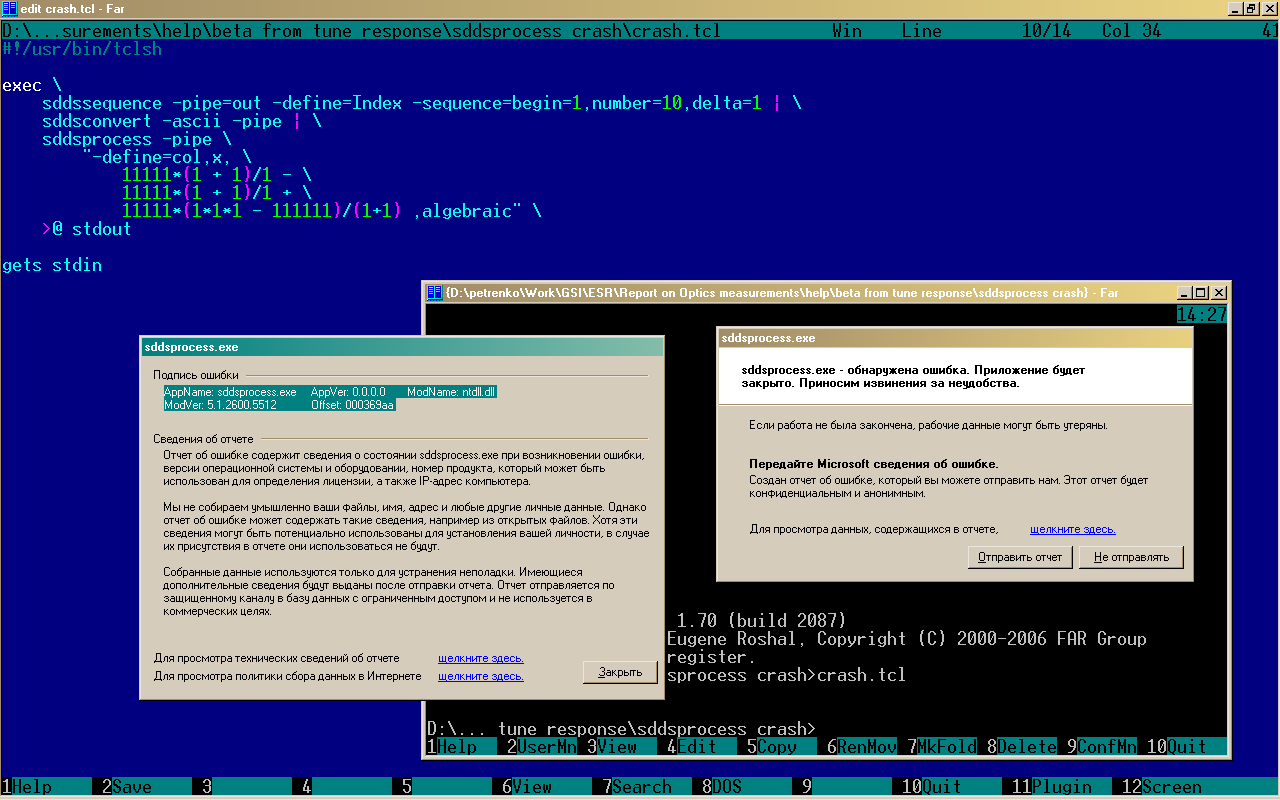

In Windows I have a strange crash of sddsprocess executed with "algebraic" option:
Code: Select all
#!/usr/bin/tclsh
exec \
    sddssequence -pipe=out -define=Index -sequence=begin=1,number=10,delta=1 | \
    sddsconvert -ascii -pipe | \
    sddsprocess -pipe \
	"-define=col,x, \
	    11111*(1 + 1)/1 - \
	    11111*(1 + 1)/1 + \
	    11111*(1*1*1 - 111111)/(1+1) ,algebraic" \
    >@ stdout
If you write, for example, "11111*(1*1*1 - 11111111)/(1+1)" instead of "11111*(1*1*1 - 111111)/(1+1)" it works fine.
In linux the same code works fine.
I have Win XP + ActiveTcl + latest SDDSToolkit.exe

Error happens only then the script is executed as a tcl-file.
Try to copy the script as it is into a file and run it as "tclsh85 script.tcl" or something.
Also if you write the definition in a single line no error happens.
