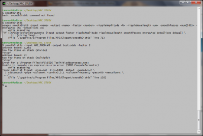

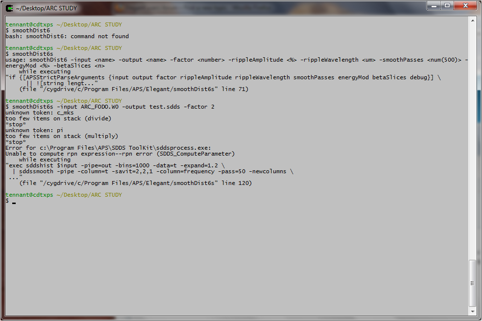

Not sure if this is a bug or not. The SDDS documentation says that the command is "smoothDist6s" but when you click on it for more details, it says it is "smoothDist6". Typing "smoothDist6" gives me an "command does not exist" error, while typing "smoothDist6s" gives me the attached message/error(?). When I try using the command on a file, I also get an error message about "unknown token: c_mks" (see attached). Is the problem on my end?

It looks like your RPN_DEFNS environment variable is not set correctly. If you type:
echo $RPN_DEFNS
do you get:
C:\WINDOWS\defns.rpn or something similar and does this file exist? It should be installed by the Elegant installation.

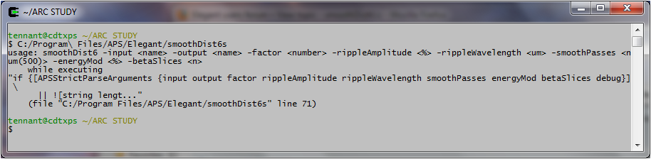

Okay, so I thought it was working... when I type in the command on cygwin I get the attached message. I also tried passing an input file and setting ripple and amplitude and I get almost the same message. Help please! Thanks.
