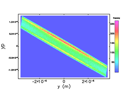

I find this bug show up again in version 26.0.2, with incorrect vertical focusing when the field expansion is set to "leading-terms" or "exact".
Zhen
Zhen

I tested LSRMDLTR against WIGGLER and CWIGGLER, and the focusing seems correct for both "leading terms" and "exact" expansions. Can you check again, and send an example input file that shows the problem?
Thanks--Michael
Thanks--Michael

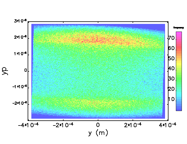

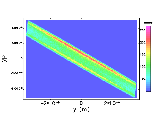

Attached please find the input files of LSRMDLTR. For different FIELD_EXPANSION I found the final phase space t-yp and y-yp were different. There were vertical focusing when it was "leading terms" or "exact". The code version is 26.0.2 on the oak cluster of SLAC.
Thanks.
Zhen
Thanks.
Zhen

If I turn the laser off, I can compare the results to other methods in elegant. Doing this shows nearly exact agreement between the LSRMDLTR (exact and leading-terms modes) and CWIGGLER elements, which are implemented in completely different ways (by different people). So I think the LSRMDLTR is getting the focusing correct. It "ideal" method of course is not correct.
Am I missing something?
