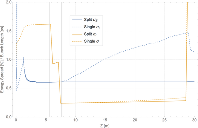

I have a beamline with a compressing dogleg, and some LSC-induced energy spread growth in the line *after* the dogleg, when I am at maximum compression. This is expected.
However, if I split my lattice into (say), DOGLEG.lte, POST-DOGLEG.lte etc. and track using the output of the previous lattice section as the input to the SDDS_BEAM command, I no longer see LSC-induced energy-spread in the post-dogleg section. All other parameters stay the same except the longitudinal ones, that would be expected to grow due to LSC. CSR and other effects are off (but do not change the basic result).
"Split" and "Single" Lattices are identical (combining all "Split" lattices, does give the "Single" lattice).
Is there something wrong with what I am doing? Or is there a method I can call to "fix" this?
I have included a plot, illustrating the issue (hopefully it is clear what is going on!). The location of the splitting between lattice files is highlighted.

Hi,
Apologies, but I have fixed my own stupidity here. I was using CSRDRIFTs (since I have a 2-dipole chicane), and the LSC works in the CSRDRIFT after the dipole in the SINGLE lattice case. In the SPLIT lattice, (since there are no dipoles in the POST-DOGLEG.lte) file, CSRDRIFTS do not work in terms of LSC. Changing the drifts to LSCDRIFTS and now I get the expected energy-spread increase.
However, another question: Is there any way to enable LSC for CSRDRIFTS even if there is no CSR-emitting elements in the lattice?
My code generates the lattices programmatically, and it's not trivial to switch between LSCDRIFT and CSRDRIFT only after a dipole (which is why I was using CSRDRIFT everywhere). I realise this is my problem and not yours, but...
