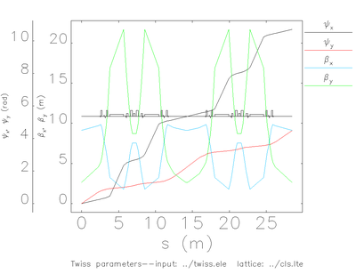

If I set the entrance and exit kicks to zero, I get a vertical phase advance of 4.482 rad = 0.7133 x 2 pi rad. Here is the resulting plot of the beta and psi.

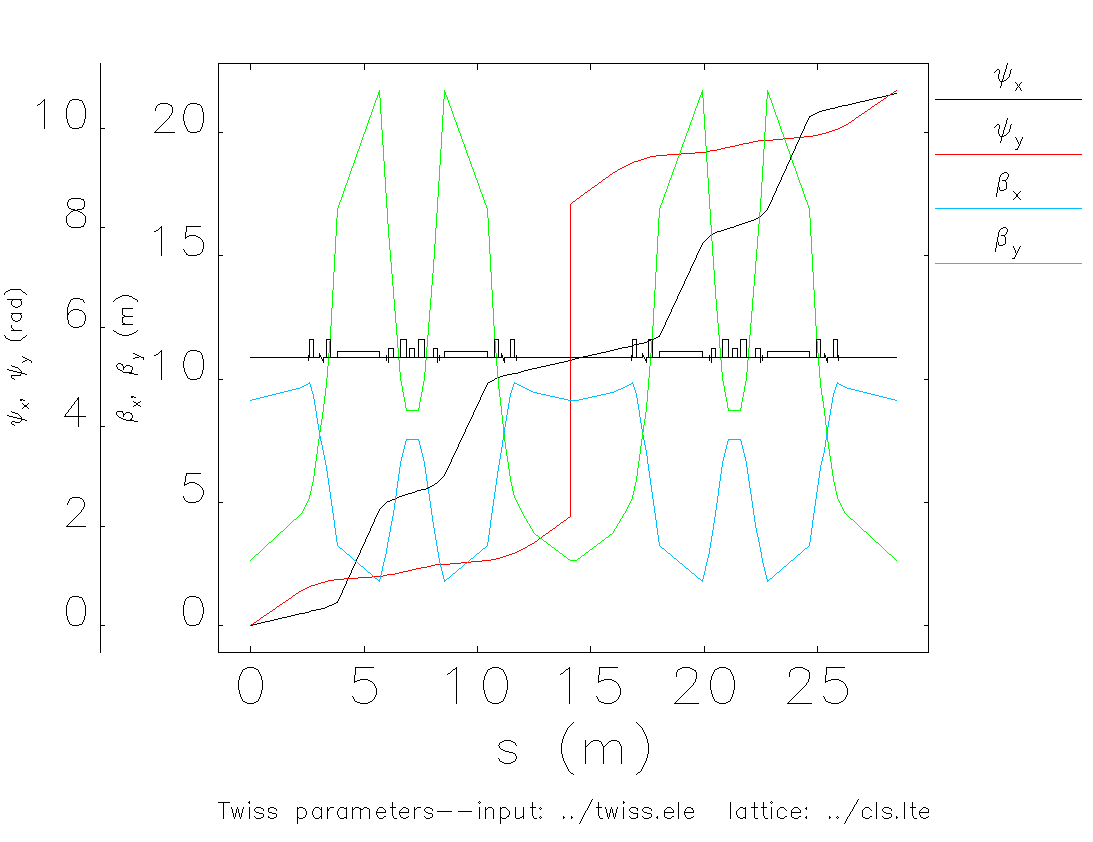

However, if I include the entrance and exit kicks, I get a vertical phase advance of 10.765 rad = 1.7134 x 2 pi rad. This is one tune integer more than expected. Here is the resulting plot of beta and psi. Note the discontinuity, which occurs at the second kick (the downstream end of the ID).

This is a problem of numerical accuracy in determination of the matrix for the FMULT element. For FMULT, elegant uses particle tracking to find an approximate matrix (linear and higher-order, if needed). In your case, the matrix for one of the FMULT elements has very small R34<0, which looks to elegant like a phase advance of nearly 2*Pi. That's where the extra integer originates.
You can "fix" the problem by changing the step factor for tracking-based matrix determination, using
before your &run_setup command.
You can also give the FMULT elements a small, nonzero length, e.g, 1e-6.
The reason you didn't see this in the previous version is that the previous version ignored FMULT elements for computation of twiss parameters (if I recall correctly).
