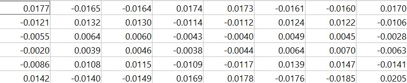

Dear Bob,
when I continued my playing with sddspseudoinverse I faced with the next strange behaviour of the code.
If I use matrix prepared in other program and then make table data in sdds format via csv2sdds command and finally call sddspseudoinverse the result differs from that is obtained with MtLab. I attached input matrix and the result of the sddspseudoinverse as well as the result from MtLab (look at the picture).
Can you explain what is happened?

Re: sddspseudoinverse error
Try this:
sddspseudoinverse matrix.sdds matrix.inv.sdds -ascii -minimumSingularValueRatio=1.7763568394002505e-15 -economy
I was able to reproduce MATLAB's pinv output with this command on Linux. I haven't tried it yet on Windows.
minimumSingularValueRatio = max(m,n) * eps = 8 * 2.220446049250313e-16
eps is “machine epsilon”: the size of the smallest relative change that double‑precision floating point (IEEE‑754 double) can reliably represent around 1.0
MATLAB pinv(A) computes the Moore–Penrose pseudoinverse using an SVD and a specific default rule for deciding which singular values are “effectively zero” in finite‑precision arithmetic. sddspseudoinverse also uses an SVD, but it will only match MATLAB if you make it use the same cutoff rule and avoid extra filtering features.
Without the -minimumSingularValueRatio=<max(m,n)*eps> option, sddspseudoinverse may keep and invert singular values that MATLAB would discard.
