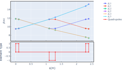

Both warning messages - the one that I showed you and the one that you mention, are being displayed only in the case when ANGLE is small. When ANGLE=0 there are no messages and SBEND or CSBEND is not treated as KQUAD, K1 is ignored.
I made an example illustrating the issue. Mistakes are possible.
run.ele - script with 3 examples
1 - fodo made with KQUADS only
2 - fodo starting and ending with halves of focusing KQUADS, CSBEND with negative K1 and ANGLE=0 in the center
3 - same as 2, but ANGLE of defocusing K1 in CSBEND is 1e-20
fodo.lte - fodo beamlines, first with KQUADS, second with CSBEND in the middle
run.log - log file with terminal output. You can see from this log that there are no warnings when ANGLE=0 (2nd example)
You can see from the attached figure that in cases 2 and 3 CSBEND behaves as drift.

Post by michael_borland » 16 Apr 2025, 11:18
Mikhail,
You are correct that there is a bug when the angle is very small. If you build from source, the attached files contain the fix. Otherwise, the fix will appear in the next version.
Thanks for reporting this bug.
