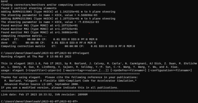

I tried running "&correct" on a Windows machine with a recent elegant version (2022 Nov. 15).
But it was completed prematurely without any error message (see the attached picture).
The same file is tried on a different version (2018 Jun 13) and works fine. It looks like a bug.
Could you check it and please update the code?

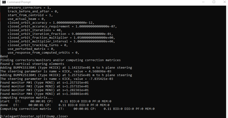

I can't duplicate the problem with version 2022.0. I've attached my files.

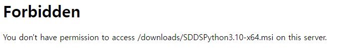

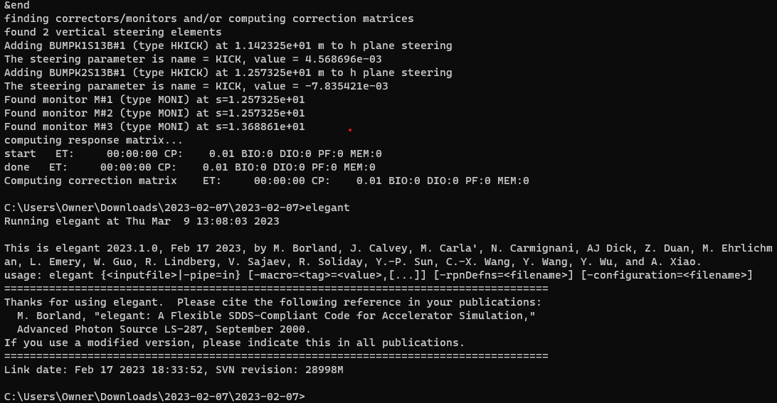

I tried to run the attached file on a Windows machine with the recent version of Elegant (2023.1.0) but it was not working. Apart from this issue, the download of SDDS Python 3.10x64.msi on the APS website is not accessible.
https://www.aps.anl.gov/Accelerator-Ope ... re#elegant Best regards
Ji-Gwang Hwang
Ji-Gwang Hwang
- Posts: 2054
Re: Orbit correction bug
Ji-Gwang,
I tried the files I uploaded on a Windows 11 machine from the cygwin shell using the latest 64 bit versions from our web site. It ran without any issues. I'm not sure what to suggest. Perhaps try another machine?
