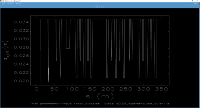

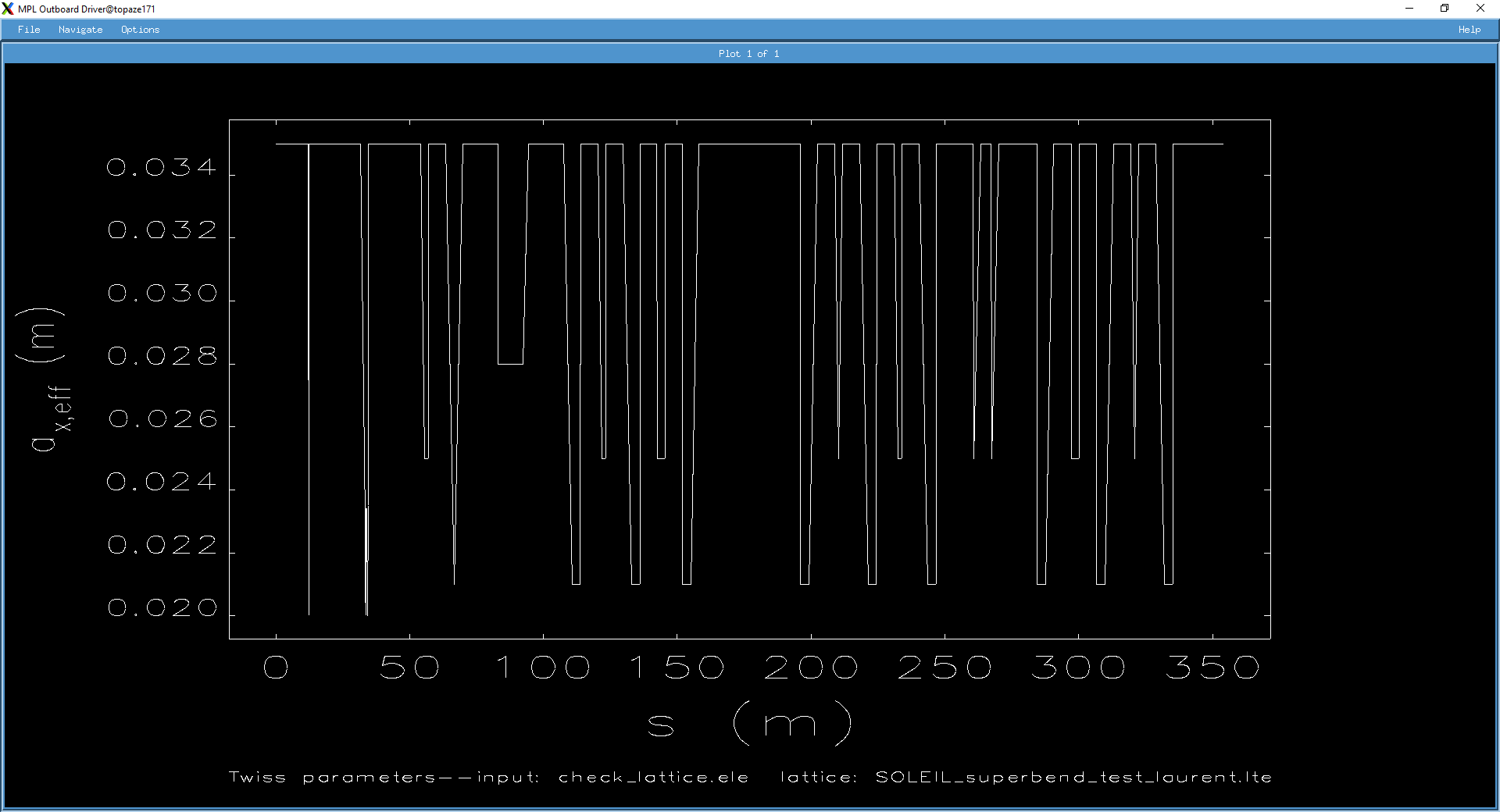

However, there is another problem now, as the aperture behaves differently with respect to the longitudinal position.
The complete files are attached but we can focus on two specific IDs.
Let's consider for instance the IDs called SIXS and SIRIUS in the sdds file (their apertures are defined at the end of this file).
SIXS starts at s = 297.2339 m (Its entrance is marked by the BPM marker) and SIRIUS starts at s = 319.4663 m. Their aperture is definded in the same manner, except the values differ.
I run check_lattice and check the apertures with sddsplot. The result is given in figure pa.png. You can see the problem...
When I look closely in the vicinity of these two with sddsprintout -col=ElementName -col=s -col=?Aperture randy_test.twi I get :

In the case of SIXS the aperture extends correctly along the ID whereas it does not in the case of SIRIUS.
You can see that this behaviour is not an isolated case. Sometimes it works (sadly not very often) and sometimes not. I can not figure out why, do you have any clue ?

There are a few reasons for this behavior. First, your aperture input file includes infinite-slope transitions, as seen by identical s values on subsequent rows of the file; this is apt to confuse the interpolation of the aperture vs s. Second, the aperture is computed only at the ends of elements; it doesn't show the aperture just before and after the transitions, so when plotted with the original input, it will look different.
My suggestion for solving this is
- Revise the aperture file to eliminate the infinite slope transitions.
- Interpolate the aperture file with a spacing of, say, 1 mm in s. You can use
Code: Select all
sddsinterp ap-old.sdds ap-new.sdds -equispaced=0.001 -column=s,* - Divide the drift spaces more finely in the lattice file. You can do this by adding the following command at the top of the command file
Code: Select all
÷_elements name = *, type = *DRIF*, maximum_length = 0.001 &end
