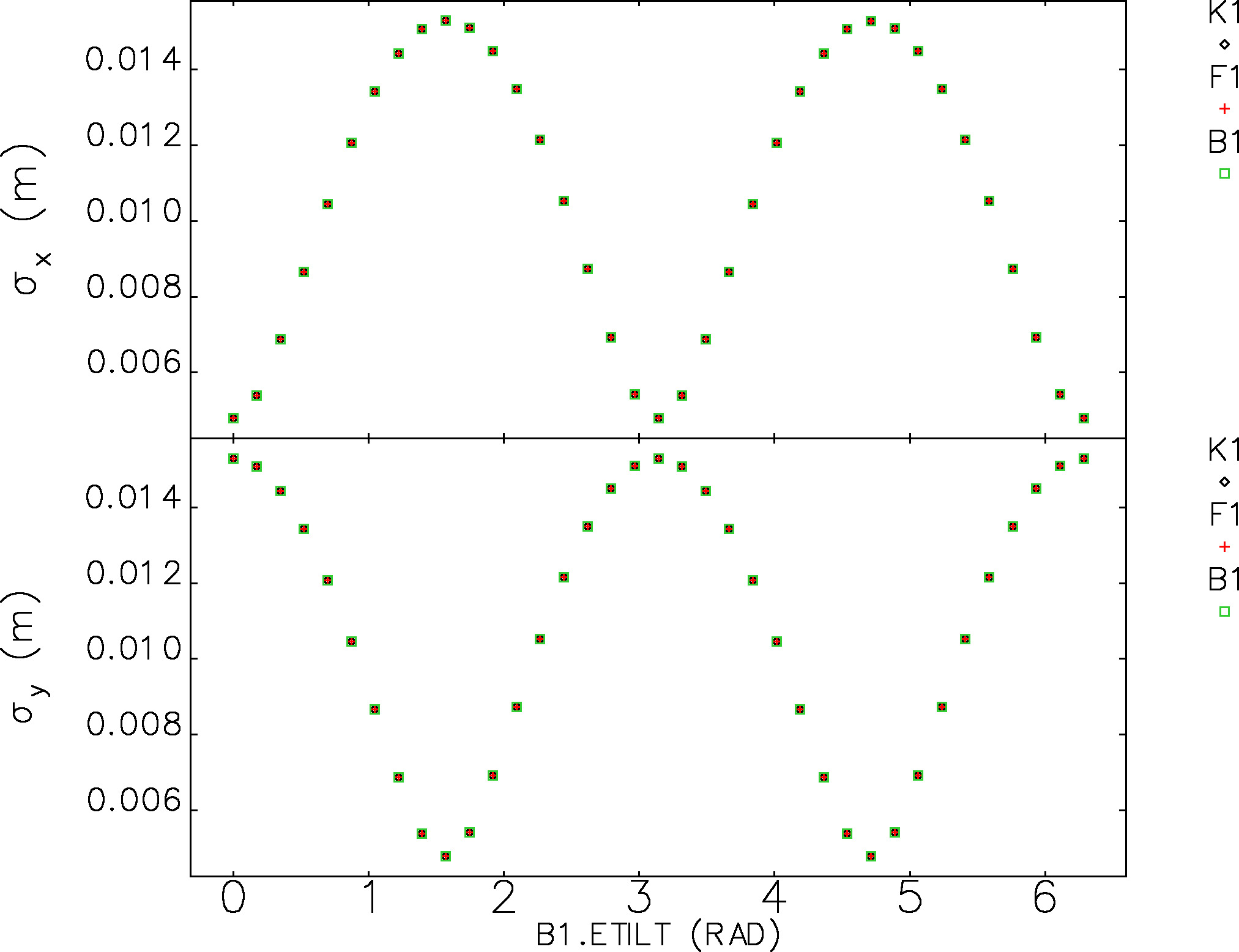

Sorry for the poor timing of this post. I see several problems with the tracking in CSBEND elements that include error terms. I've been tracking particle through bends using specific errors, rather than only looking at rms quantities.
First, ETILT does not seem to work properly. This seems related to Zhe's post at
viewtopic.php?f=19&t=914
When the rotation angle phi<<1, my best fit for how to set the parameters is to make
ETILT=-phi*sqrt(3)/2
Note the - sign. On the other hand, rotations of 2 pi have no impact, as expected. Maybe in csbend.c, the convertFromCSBendCoords and convertToCSBendCoords routines are reversed? Another symptom is that the vertical displacement of a particle is proportional to (1+delta), where delta is the momentum offset. It should scale like 1/(1+delta). An example figure is below, where the CSBEND element is between s=1 and s=2. The rest is drifts. I see the same issue when using REFERENCE_CORRECTION=1, and for rectangular bend magnets (E1=E1=angle/2 where angle is the bending angle).
Also, there is an error when the CSBEND element is displaced horizontally using DX. The final position of the particles is not consistent with taking away the displacement of the CSBEND and instead first shifting the particles in the opposite direction, then displacing everything back at the end. The error scales linearly with DX. However, the final angle x' is exactly the same in all cases. Again, the same effect is seen using REFERENCE_CORRECTION=1 and for rectangular bend magnets. Figure is below.
Finally, whenever using REFERENCE_CORRECTION=1, it seems that the value of FSE_DIPOLE is ignored. I cannot tell if it's simply acting like FSE_DIPOLE=0, or if it's recalculating the reference orbit for the actual bending strength rather than the nominal value. This one I didn't include an example for, but it's very obvious especially for a plain dipole with just an FSE_DIPOLE term.
For the other two cases, the simulations and more extensive plots are in the zip file. I'm using the most recent version of elegant, version 2019.4.0, using the pre-compiled Mac binaries from the website. These errors were in earlier versions too.

Thank you for looking into this, Mike.
For the DX issue, the fact that a shift in x means different things at the entrance and exit makes sense. I hadn't taken that into account. The difference is very close to DX*(1-cos(angle)). Is that why there is also a change in the 't' coordinate? Because it could end up inside where the nominal magnet is supposed to be.
I think I am now clear on the sign conventions for ETILT and TILT. In the manual for CSBEND, the only difference in the description is that TILT is called the 'rotation', and ETILT is called the 'error rotation', so it's not obvious that they are supposed to go in opposite directions. I was assuming that if TILT and ETILT were both 1.e-3, that means the magnet was supposed to be rotated by 1 mrad but was actually rotated by twice that amount, but that configuration would actually correspond to someone forgetting to rotate it at all.
Anyway, I still think there is something strange about off-momentum trajectories in a bend with ETILT. I am including another attempt at making a comparison. I will post the full files in a separate message. I think you will also see something if you repeat what you did with looking at the floor coordinates but with an off-momentum particle. What I did in the attached files is look at 3 cases: a dipole with a tilt of -0.01 rad, a horizontal kicker (actually a quad with K1=0 and a negative hkick) with a tilt of -0.01 rad, and a dipole with an etilt of +0.01 rad. You can see that the dipole with a tilt labels the on-momentum particle as being the reference orbit, but it's really getting a kick in the +y direction. Higher energy particles do not get kicked as much, which shows up as a negative yp. The HKICK does not have any effect on the coordinate system, so a nominal energy particle has a yp of 0.1 mrad, and particles with higher energy get kicked less. But the difference from the nominal momentum is almost exactly the same as for the case of a tilted dipole. For a dipole with an etilt, the nominal momentum trajectory matches the HKICK example. However, higher energy particles get more of a vertical kick instead of having a straighter trajectory, which does not make sense.
In the file csbend.c there are some references to a notebook, is that something I could take a look at to better understand the code?
Thanks,
Gregg

I am attaching the set of files for the figures in the previous message.
One thing in csbend.c that looks suspicious to me is there are a few places with the line
ttilt = tilt + etilt;
and I assume that ttilt is supposed to be the total tilt. But with the sign conventions as they are, maybe it should be ttilt=tilt-etilt?
-Gregg
-Gregg

The revised code works great. Now putting ETILT and TILT with the same sign gives completely consistent behavior including for off-momentum particles.
I have one final question just to make sure I'm interpreting things correctly. It looks like in the CSBEND element, FSE and ETILT do not impact quadrupole or sextupole fields, although higher order multipoles are adjusted. I haven't checked all the combinations (I've been using F1 and F2 instead of K1 and K2 for example) but that's how it looks to me.

My tests show that the quadrupole field tilts with the bending field regardless of how I specify it. See attached. --Michael

That clarifies things a lot. I think the problem is simply that I'm comparing elegant to a model that is too simplistic. It's harder than I thought to account for the difference between the physical centerline of the magnet and the reference orbit when there is an error in the tilt. I'm sure you know all about that!
