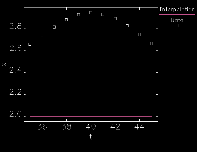

Dear colleagues,
Please fix the sddsinterp program. It does not work properly in the latest SDDSToolkit (version 2.9-2, both in Linux and in Windows).
Here is the data and the result (png image) of sddsinterp command:
sddsinterp data.sdds interpolation.sdds -columns=t,x -order=4 -sequence=250
For some reason the sddsinterp returns only the integer part of interpolation.
Thank you!
/Alexey.

Okay, it turns out the problem was fixed a while ago but after our last release. So I just created a new release for Linux and Windows using the patched sddsinterp code. You should be able to download it from the web now.

Thank you! It's fine now.
