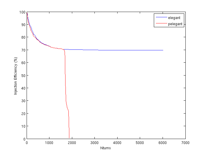

Hi everyone,
to speed up the calculation of injection efficiency in Diamond I am using pelegant. I have done a "crash" test with a large number of turns (6000) and 1000 paricles, to determine the minimum number of turns to define this parameter. The puzzling result is that while (plain) elegant shows a plateau after ~ 2000 turns, pelegant exhibits a dramatic drop at about 1630 turns. I am investigating the reasons for this anomaly, but so far the only difference I can see in the two cases is switching between elegant and pelegant while doing the tracking. Anyone else saw this effect? Thanks.

Re: Injection Efficiency with pelegant
This is definitely not supposed to happen. Can you post (or send me) the input files for Pelegant?
Also, you may want to be sure you have the latest version of Pelegant, 28.1.0.
Hi Michael it took me some time to check the actual settings and do some tests:
A) This are the files I use in my calculation, .
B) the plot I have posted, with the dramatic change in Inj. Eff. after 1630 turns was indeed produced with an old Pelegant version: 25.2.2
Just to give an idea of the times, 1500 turns (still with eff > 70%), 1000 particles and 100 nodes is performed 2m40s. Pretty fast.
C) I have repeated the calculations with Pelegant v = 28.1.0, I understand there was a bug related to the center_on_orbit feature in the &track command the version we are using is compiled from the sources for 28.1.0 with this patch to fix the above bug. With this version for Pelegant I get

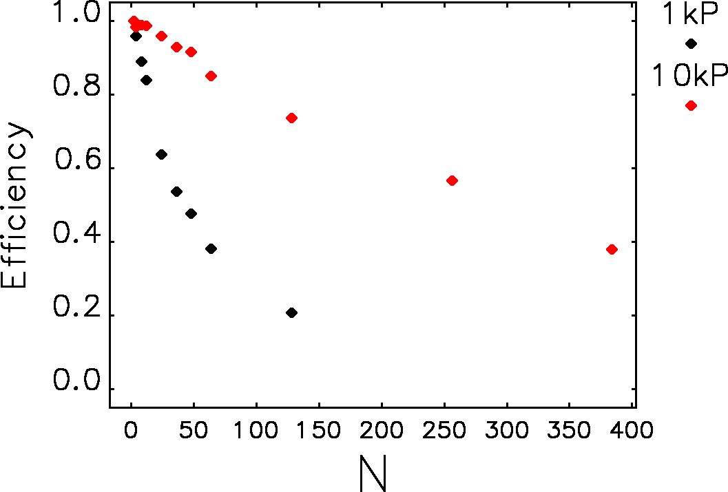

- Posts: 2060
Marco,
I did a scaling study for your input files. First, I removed the WATCH element with mode="coordinates" and substituted one with mode="parameters", just to avoid excessive I/O. I did runs with 1k and 10k particles. As I suspected, 1k particles is not sufficient to make good use of more than about 30 cores. With 10k particles, scaling is decent up to 256 cores.
Depending on the speed of your network and your file system, your scaling results may be better or worse than this.
