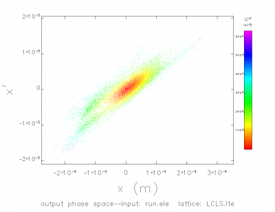

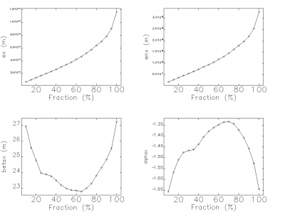

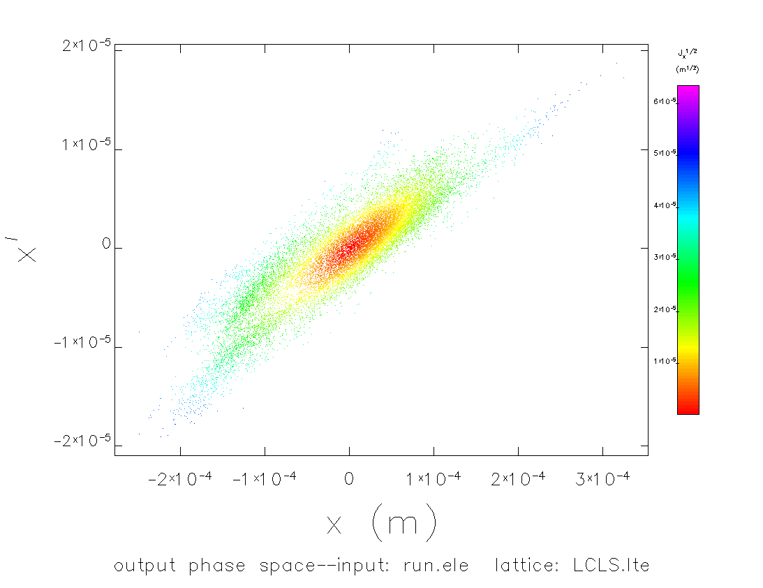

- Posts: 2050
Re: sddscontour
Here are some sample plots.
