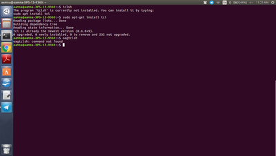

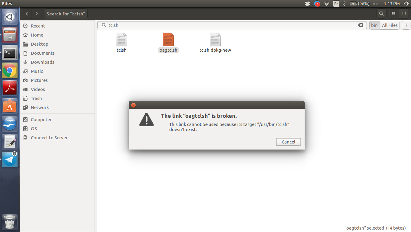

Post by Aamna_Khan » 18 Jun 2018, 04:23
Hi,
Sorry for late reply. I installed the latest version of oagtclsh provided by you in the link. After typing oagtclsh still it shows me oagtclsh is not found.
It was working fine before that....I have worked with another scripts using oagtclsh and may be I messed up something and not able to figure out.
tclsh and oagtclsh are there in /usr/bin.
Aamna

tclsh has to be installed before you install OAGTclTk. Since you now have tclsh installed, try reinstalling OAGTclTk. You may have to manually delete /usr/bin/oagtclsh and /usr/bin/oagwish first.

You also need the tk package installed first.

Post by Aamna_Khan » 18 Jun 2018, 10:41
I delteted everything and re-installed. Still same thing.
Problem is tclsh is there but still it shows:
The program 'tclsh' is currently not installed. You can install it by typing:
sudo apt install tcl
maybe something wrong with tcl installation...
