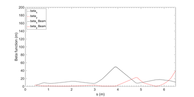

for example,
s (m) betax (m) betay (m)
1.498676e+01 8.014801e-01 9.208712e-01
1.513676e+01 9.293887e-01 1.012960e+00 ,
and,
s (m) betaxBeam (m) betayBeam (m)
1.498676e+01 8.225385e-01 9.195021e-01
1.513676e+01 9.361804e-01 1.021141e+00
Indeed I am wondering why the Twiss parameters calculated from the beam distribution (on tracking) is different from the
Twiss parameters obtained by Twiss_output, and wondering what the difference comes from.
And also I am wondering if I could safely say that the beam size (Sx, Sy) is still valid even if the betaxBeam / betayBeam
value is still different from the one obtained by Twiss_output. Plus if possible, is there a way to make the betaxBeam
to be same as the beta function in Twiss_output?

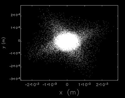

With another beam distribution, I've check that the beta function in Twiss_output and betax / betayBeam is almost similar.
In this case the beam is truncated Gaussian (cut by 2sigma) with some dispersion (I've obatined this distribution also from ASTRA).
However in the case where the beam distribution is almost flattop attached in the mail, the beta function is not same even on the first quadrupole.
I am wondering it is then due to the beam distribution, or to something another reason.
Maybe I think that it is indeed due to the beam distribution. Since it is not uniform distribution, there should be emittance variation
when the beam is propagating through the beamline. Due to the variation, I think the beta function, beta = sigma^2 / emittance will not
hold the case for the real beam distribution. Therefore, I think it is the reason why the calculated beta function from the beam distribution
is also not same as the value obatined from Twiss_output.

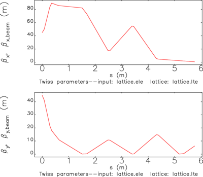

I checked the files you sent me via email. The issue is that you have significant energy spread in the beam, while also having ORDER=2 on the dipole elements. This leads to chromatic effects in the tracking that affect the beam sizes, and thus the beam-derived lattice functions.
If I set ORDER=1 on the dipoles (and leave default_order=1 in &run_setup, as you have it), I get near perfect agreement, as shown in the figure.
