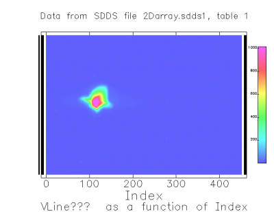

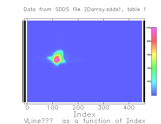

Here's a script that converts your image file to two SDDS files.
% convertImage 2Darray.txt 2Darray1.sdds 2Darray2.sdds
The first output file is organized into rows and columns just as in the input file. Each column VLine??? is a vertical line from the image. There's also a column VLineProfile that's the sum of the VLine's.
The second output file is the transpose of the first output file. Each column HLine??? is a horizontal line from the image. There's also a column HLineProfile that's the sum of the HLine's.
Suggested plotting commands:
% sddscontour -shade 2Darray1.sdds -column=Index,VLine???
% sddscontour -shade 2Darray2.sdds -column=Index,HLine???
% sddsplot -column=Index,VLineProfile 2Darray1.sdds
% sddsplot -column=Index,HLineProfile 2Darray2.sdds
You may want to use sddsbaseline for baseline removal and sddscliptails to remove halo. Also, sddsspotanalysis can be used to perform processing to get x and y image parameters.

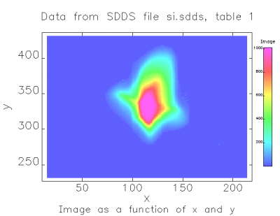

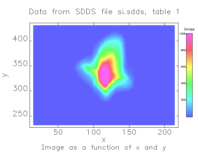

% sddsspotanalysis 2Darray.sdds1 sa.sdds -image=VLine??? -levels=intensity=1024,sat=1023 -background=halfwidth=30,symmetric,antihalo,antiloner -spotimage=si.sdds -spotROI=xval=200,yval=200
% sddscontour -shade si.sdds
Look in sa.sdds for the spot analysis results.
The attached plots show the image before and after spotanalysis.
