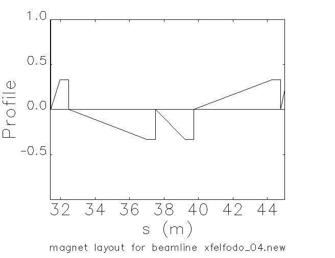

It seems that the magnet layout output becomes a little strange when CSR elements are used (namely CSRDRIFT and CSRCSBEND).
For example, here's a section of bunch compressor and you can see that D_SIDE_BC1 starts at s=3.247044e+01 and DIP2_BC1 also starts at s=3.247044e+01. I've attached an image of this plotted and you can see the magnet elements all have a slanted edge.

Is there any reason behind this? And is there a way to plot the magnet layout in it's more standard form?

Magnet layout with CSR elements
- MagnetLayout.png (5.33 KiB) Viewed 6733 times

This is a bug in older versions of elegant. If you update to the latest version, it should be resolved. If not, please let me know.
