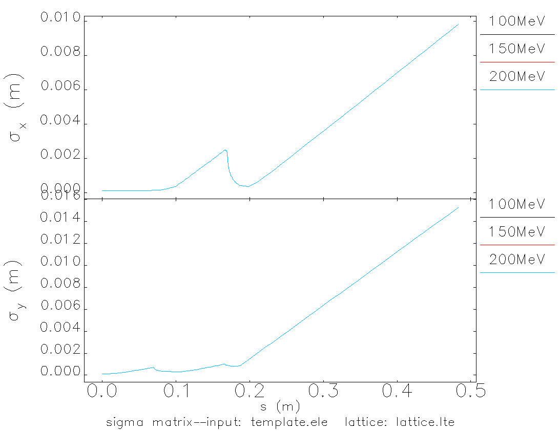

I have put together a shorter version of my .lte and .ele files for you, see attachment 1. When I run these and look at the sigma values, these change between different runs, see images in attachment 2. What I have changed between these runs is p_central and also what lattice profile I use, but these profiles should correspond to the same gradient (~167 T/m), since I have scaled the k-value accordingly. Normally, I would also have included my second q-pole triplet in the lattice file, but I left them out for the sake of simplicity.

I think the only problem is that you are using QUADRUPOLE elements, which are based on a third-order matrix expansion. This isn't good enough for extremely large momentum offsets. If you use KQUAD instead, you should see essentially perfect agreement. See attached.

So I ran it again and everything looks fine, just like in your plots
Something must have gone wrong when I tried it before.
Now, the plots look quite different from those I got with the matrix elements, but I assume that kquad gives a more realistic behavior. Will using more kicks provide a "better" result (with the trade-off of computational time)?
