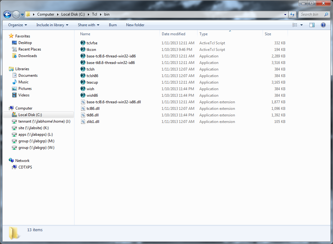

Sorry that this is turning into troubleshooting. When I look at the contents of Tcl/bin this is what I have after installation. So where is oagtclsh supposed to be? I don't know how to define a path since I can't seem to find oagtclsh. Thanks.

Sorry about that. The Window's setup is real goofy. Just copy the tclsh.exe to oagtclsh.exe. I just did a clean install on mine and that seemed to be the missing step.
