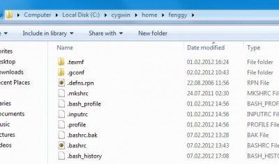

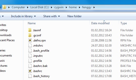

Re: Definition of rpn expression doesn't work
Hello Michael,
I have checked the file's location. They are shown in the figures bellow:

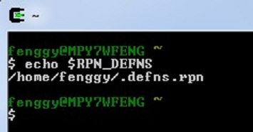

When I type echo $RPN_DEFNS I get:
C:\WINDOWS\defns.rpn
I am guessing the problem is that elegant does not understand the cygwin directory structure. Somewhere in your cygwin shell it is overwriting the RPN_DEFNS value. Try setting it back to C:\WINDOWS\defns.rpn and see if the problem disappears.

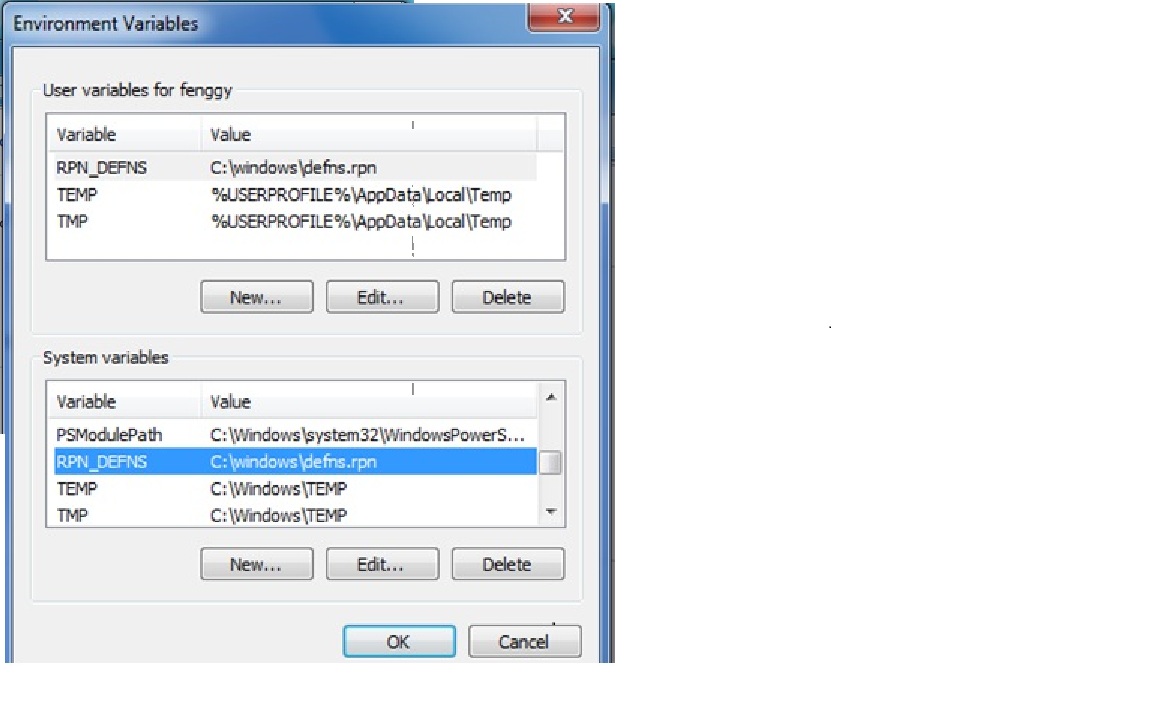

Hello,
Thank you for your help! I have setting it back to C:\WINDOWS\defns.rpn as you told.But it still doesn't work.
soliday wrote:When I type echo $RPN_DEFNS I get:
