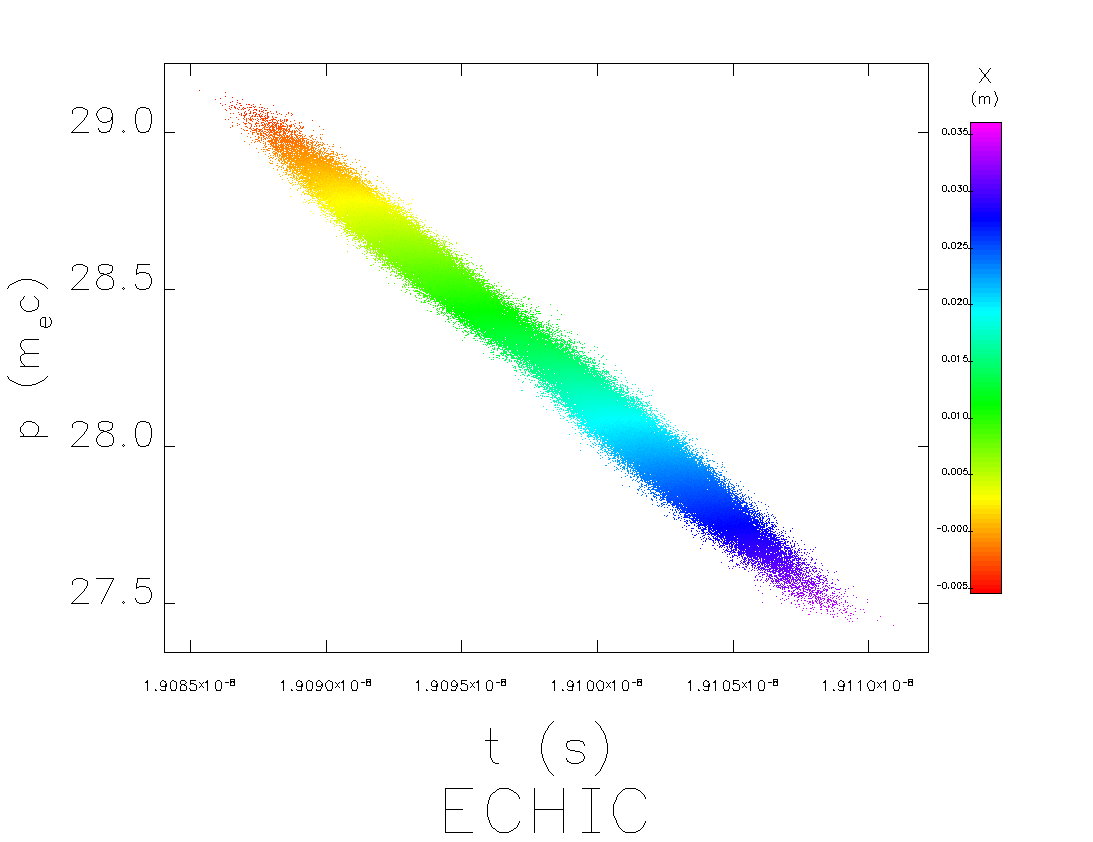

Re: double gaussian
Charles,
I plotted the data at watch point XPROBE, at it seems to show a reasonable correlation. See attached.

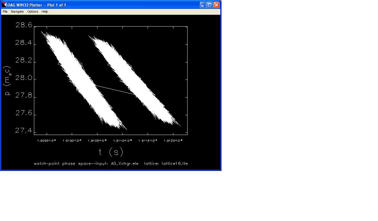

When i execute: sddsplot -col=t,p A0_Xchgr.Xprobe i get the following, which is different from what you seem to have got?
I dont understand what is going on?
btw, what is the command you used to plot...(i like the plot!)
regards,
Charles
regards,
Charles

Charles,
I think you may not be properly combining the two files to make the new beam file, since it appears that you are tracking the two sub-bunches separately. Be sure you have the "-merge" option on sddscombine.
The plot command is
sddsplot -col=t,p A0_Xchgr.XProbe -graph=dot,vary -order=spect -split=column=x -title=@PreviousElementName
The plot command is

Dear Michael,
I have tried sddscombine with the merge option. But it does not seem to make any difference. I still get the same plot. I don't get what you see at XProbe. I tried to remove the merge option and it has the same result. I can post the files if you want...Is there anything else you want me to check?
regards,
Charles
regards,
Charles
