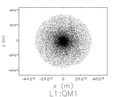

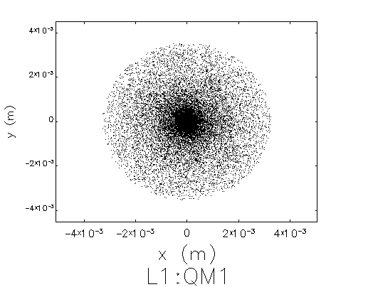

Charles,
If you have a set of WATCH point output files, this can be done, but you have to ensure that they are ordered correctly on the commandline. One way to do this is using the &insert_elements command to insert WATCH elements using the filename template feature. See the manual page for the WATCH element for more information about using a filename template.
The attached example may also be helpful.
