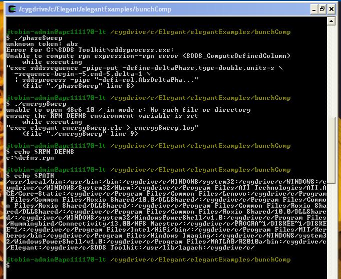

I am trying to run and test CSR in bunch compressor examples under various conditions.
When I try and run ./phaseSweep and ./energySweep i get an rpn -error. Both the $RPN_DEFNS and the $PATH show that this file is existing! What could I be doing wrong in there..I am attaching the printScreen.
regards,
Charles

I would start with this little test:
$ rpn
Welcome to rpn version 6, by Michael Borland and Robert Soliday (June 1999)
rpn> -4 abs
4.00000000000
rpn> exit
I would also try this with a simple DOS command terminal to see if the problem is cygwin specific. This test in cygwin and DOS terminals works for me.
This runs RPN directly and uses the "abs" command. If you see problems than there is probably something wrong with your $RPN_DEFNS file. I am a little surprised that your RPN_DEFNS is set to c:\defns.rpn instead of c:\windows\defns.rpn. This is where the installer puts it's defns.rpn file. But if you already have RPN_DEFNS set then it will not change it.

Hi,
rpn works fine both in DOS and cygwin by itself.
So, i don't know what could be the issue here..
regards,
Charles

Post by soliday » 22 Jun 2010, 14:04
I think I know what it happening. You are probably using the tclsh that comes with cygwin. This version of tclsh does not seem to pass the RPN_DEFNS variable to child processes. I would suggest you use your cygwin setup.exe to uninstall the tcltk package. Next go and install the ActiveTcl version 8.5.8.2 from www.activestate.com/activetcl/downloads. After this you might also want to install our OAG Tcl/Tk Interpreter from: www.aps.anl.gov/asd/oag/downloads/OAG_Tcl-Tk.exe.
This will allow you to use tclsh from ActiveTcl instead of Cygwin.
