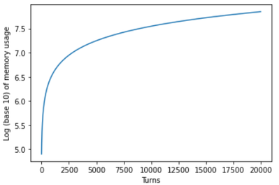

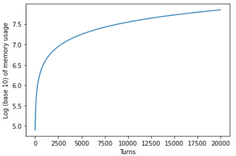

I have just recently switched modelling the collective effects from an impedance element to a wake element. It was since then my problems have been beginning; chiefly, my simulations crashing out with out-of-memory errors. After turning on the
Code: Select all
monitor_memory_usage=1
option, I was able to see:
Code: Select all
Memory usage increased by 3511 kB in ZTRANSVERSE TRANS_RW_IMPEDANCE#1, pass 23040
Looking at the WATCH output, I was also able to get the following plot:
As you can see, it increases linearly with the number of turns. To confirm, I was able to budget twice the memory on the cluster and, sure enough, it failed about twice the number of turns later.
