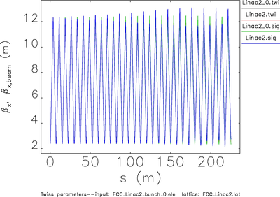

The problem is that the Twiss parameters are not what I expect.
The questions are:
- Is there a simple way to match also the emittance of the distribution like it is done for the Twiss functions, or should I do a script to do it taking the particles? (I have a smaller emittance now that before, because some margin was added for the emittance);
- Any idea of why I see this strange behaviour of the optics? Did I misunderstand anything?

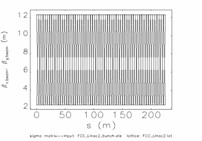

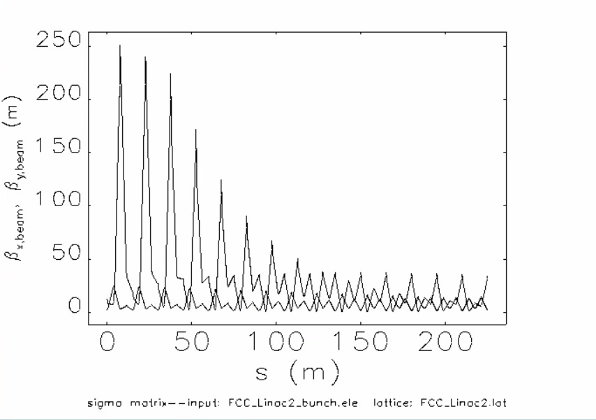

I changed the distribution I applied the matchtwiss, and I repeated the full chain.
Now I used the command:
sddsmatchtwiss Linac1.out distr_matched.sdds -xPlane=beta=2.398316e+00,alpha=5.018045512606445e-01 -yPlane=beta=1.230487e+01,alpha=-2.328639e+00
When I analize the obtained beam:
sddsanalyzebeam distr_matched.sdds dd.txt
sddsprintout dd.txt -col=betax -col=betay -col=alphax -col=alphay
I obtain:
betax betay alphax alphay
m m
2.396964e+00 1.229089e+01 5.015092e-01 -2.326002e+00
The numbers are slightly different. To be sure, I changed them in the file where I use bunched_beam to start from the same conditions, and verify that this was not the problem, and this is not. I still have different plots of the beta. I attach also this file: FCC_Linac2_bunch_0.ele.
I attach the distribution:
- Starting distribution: Linac1.out
- Obtained distribution: distr_matched.sdds
and the relevant file to do the run:
FCC_Linac2_bunch.ele, FCC_Linac2.lat, and the wake files: case using the distribution from the file
FCC_Linac2_bunch_0.ele, FCC_Linac2.lat, and the wake files: case using the .ele file to generate the distribution

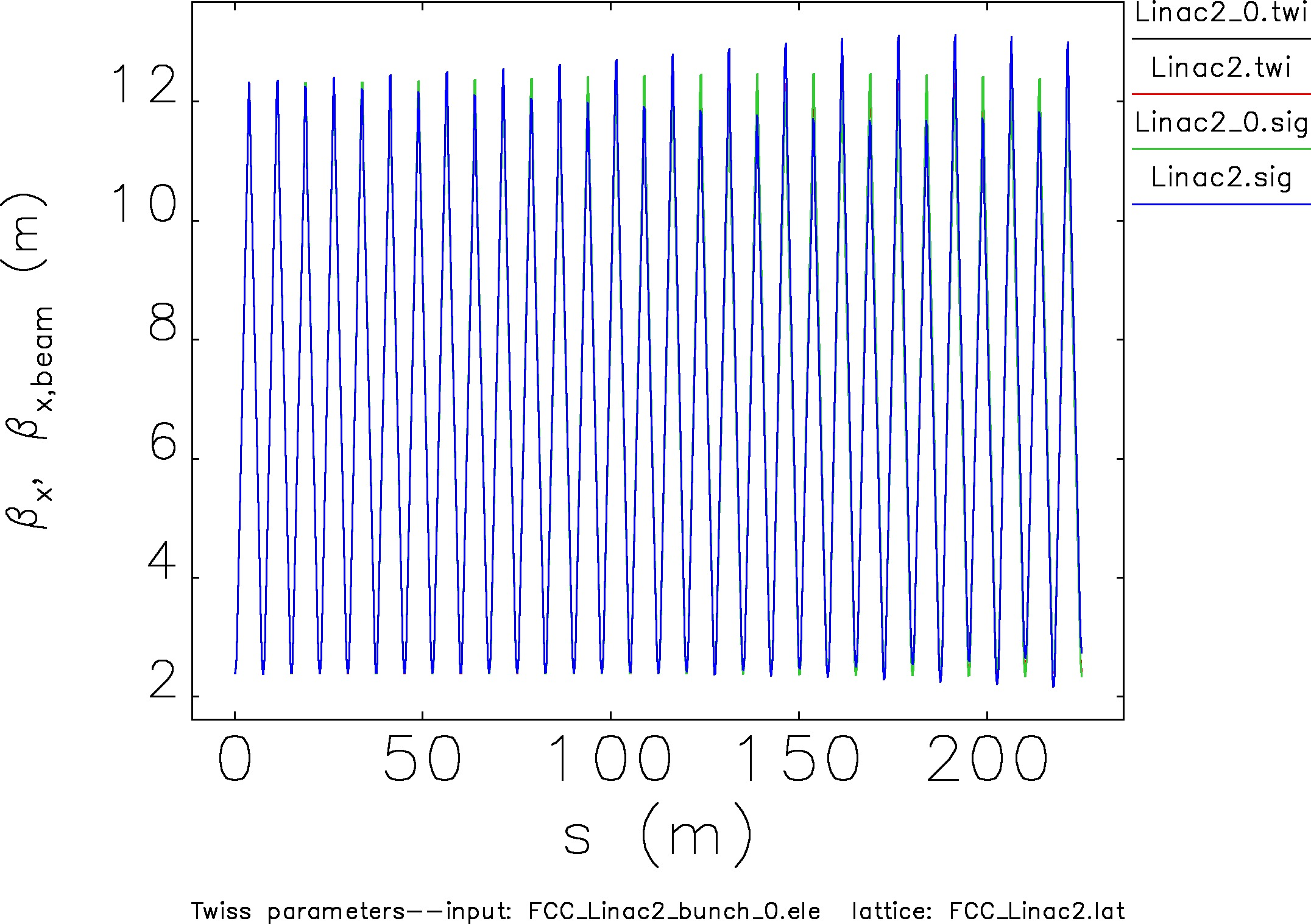

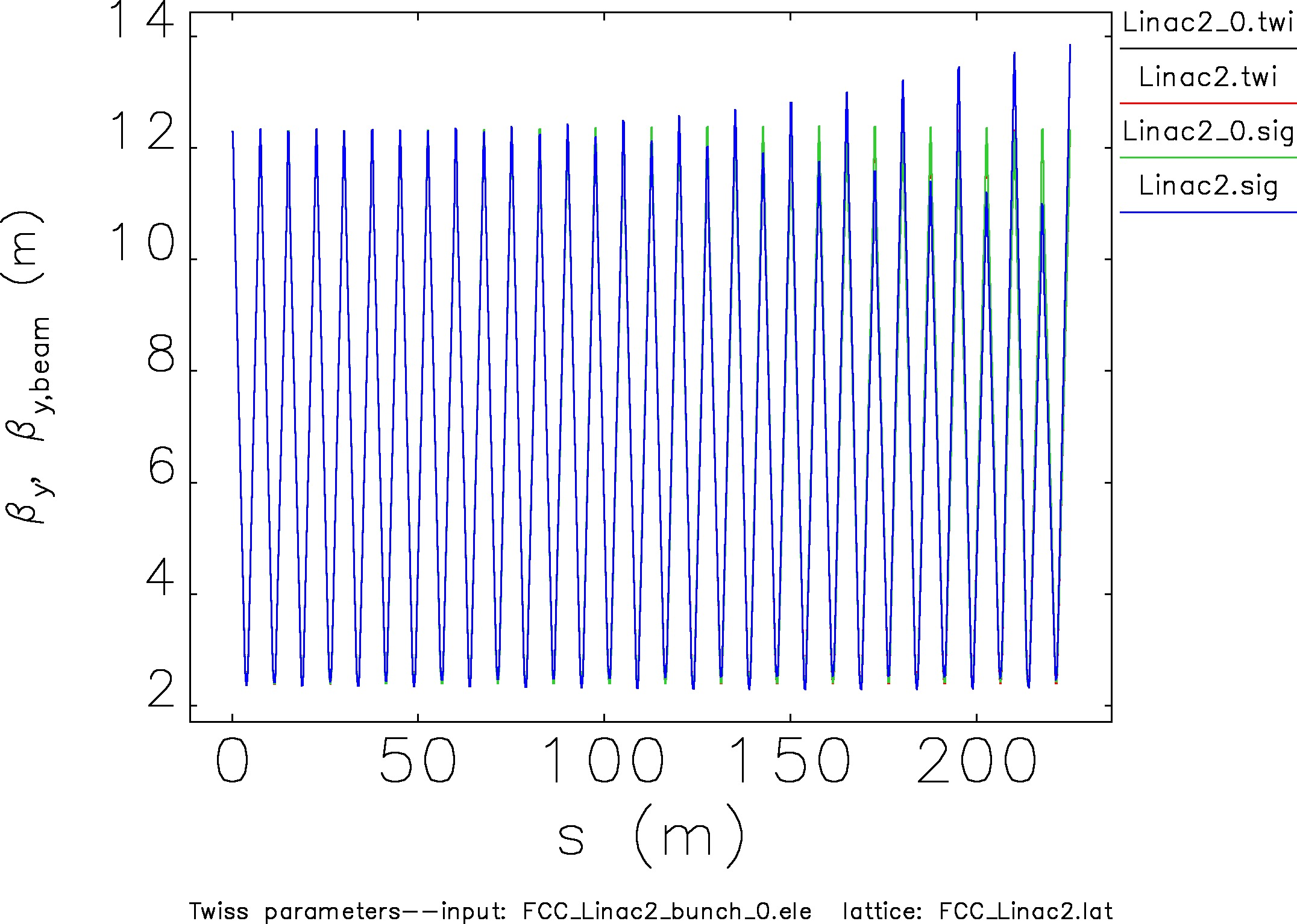

Re: Generation of the bunch
Simona,
The problem seems to be some confusion about filenames from several different runs. I made a few modification to your files and it works as expected. There is a mismatch that develops further down the beamline, but I suspect that is due to energy spread and chromatic effects. Another small issue is that sddsanalyzebeam by default does not remove energy-betatron correlations when computing the beam beta functions. Adding the -correctedOnly option forces it to do that, showing that the sddsmatchtwiss operation works as expected.
