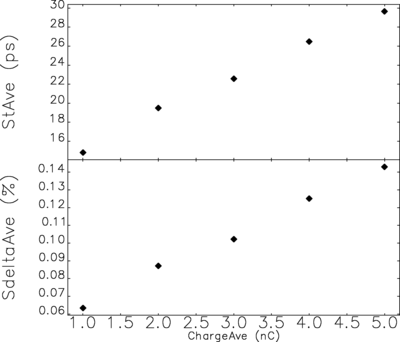

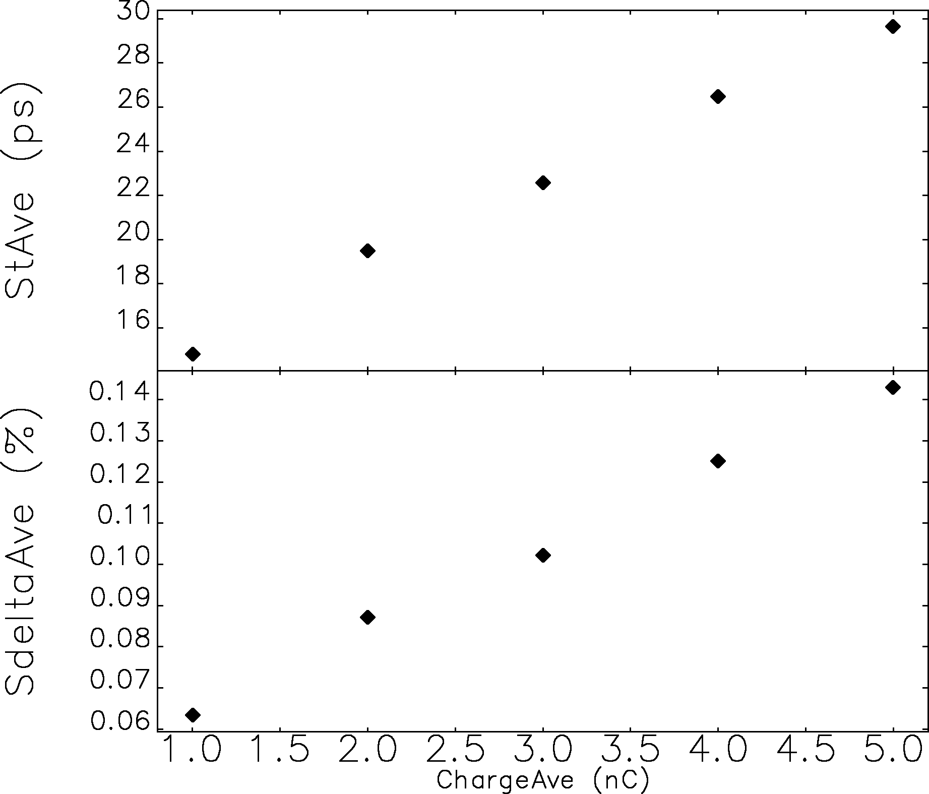

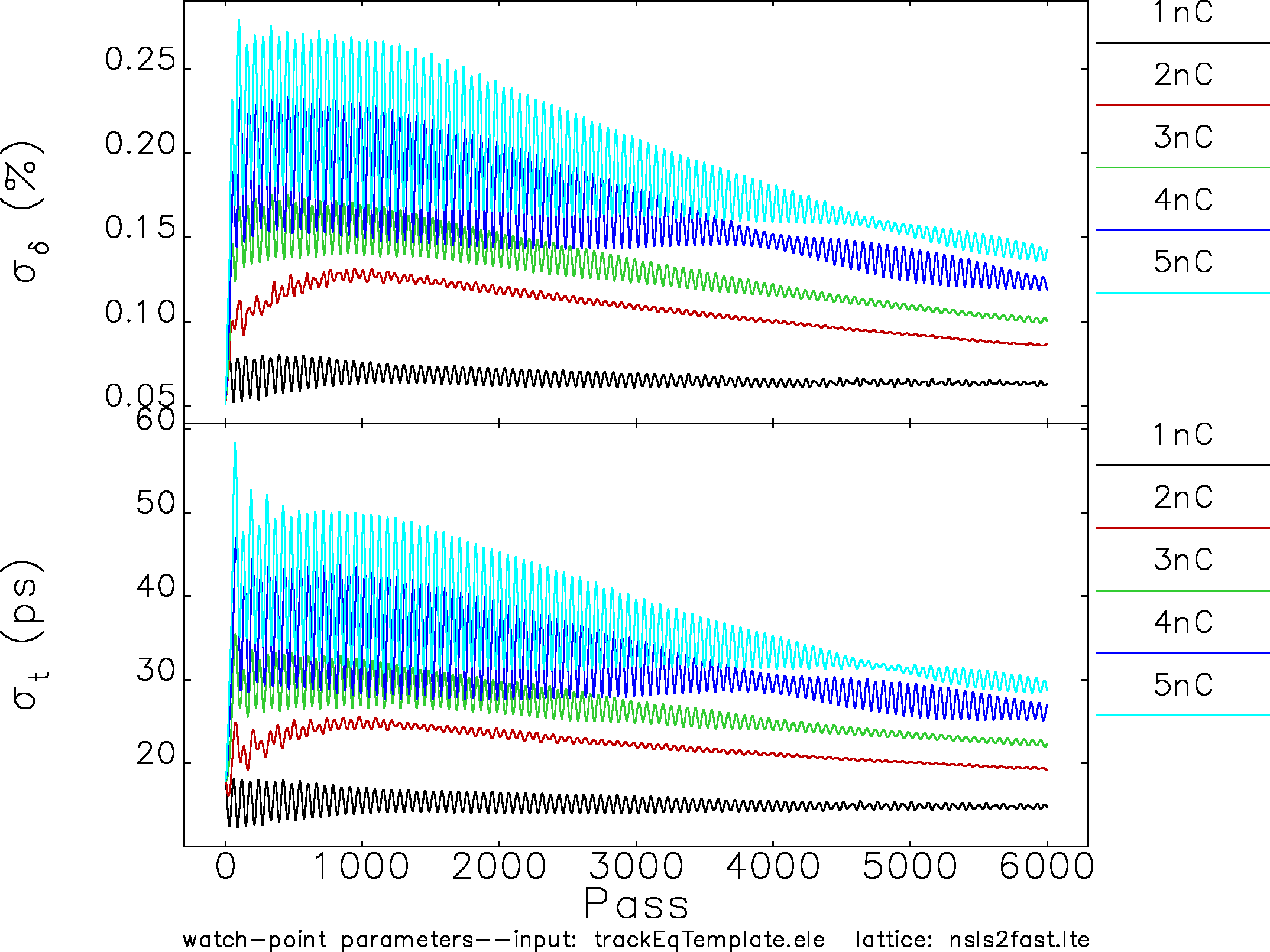

Attached is an example of how to do this, using your lattice file. In brief, you should use ILMATRIX for such tracking as it is much faster and has sufficient physics.
Here are some beam parameters vs pass number Here are the same parameters averaged over the last 500 turns vs charge --Michael

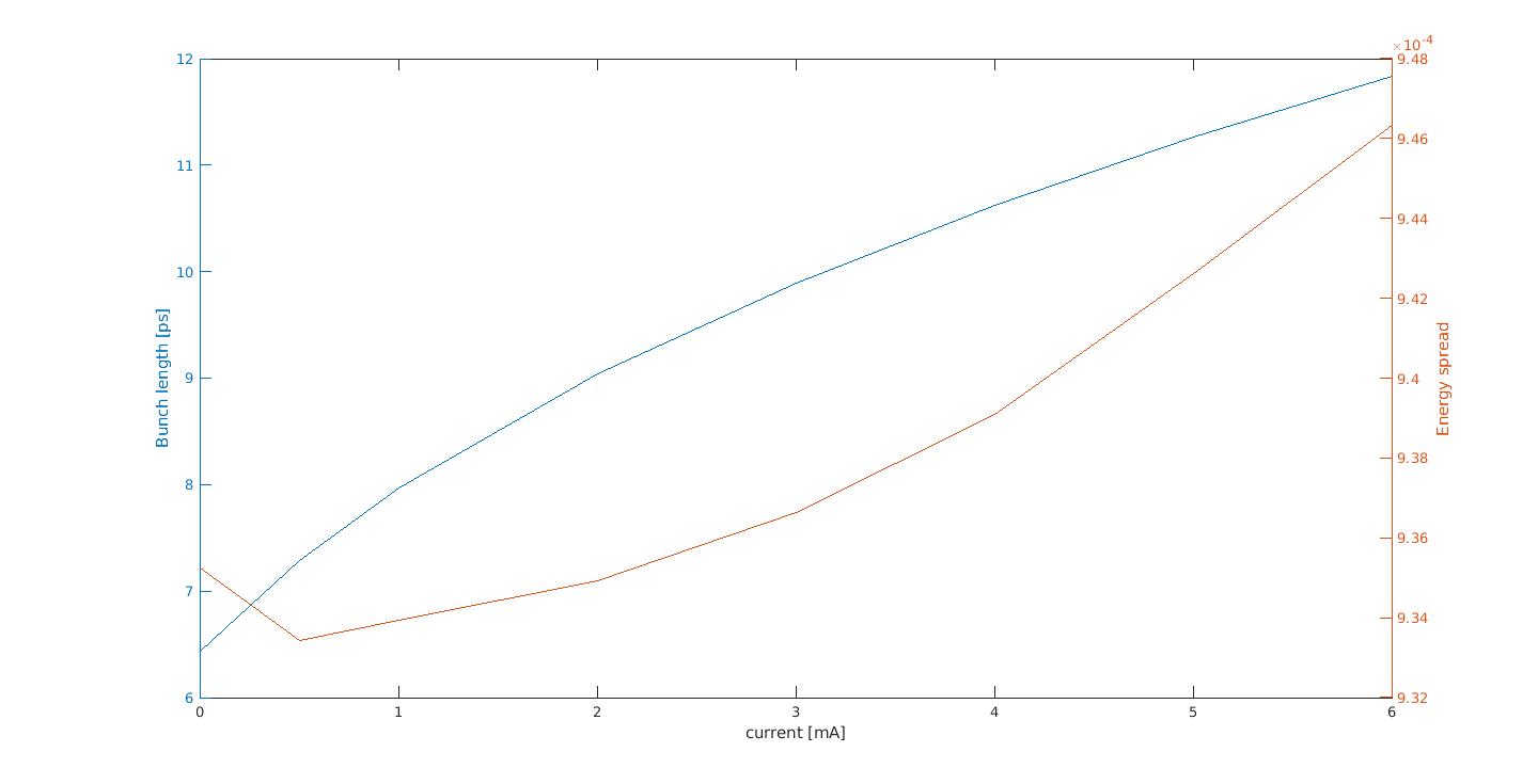

I try to simulate the microwave instability by tracking in Elegant but I can't find any logical result by changing the current from 0 to 6 mA. I used ZLONG by these parameters:
Rs=0.8 (ohm), f=7MGH and Q=1. It seems that the tracking doesn't see any instability or I made a mistake but I don't have any bunch length or energy spread increasing. The unusual result is like this: I attached my files too and it will be great if you can take a look at on it. Thanks in advance.

Sara,
At first blush, I guess it is because your 2-ps bin size is too large for a 6 ps rms bunch duration. Try 0.1 ps.

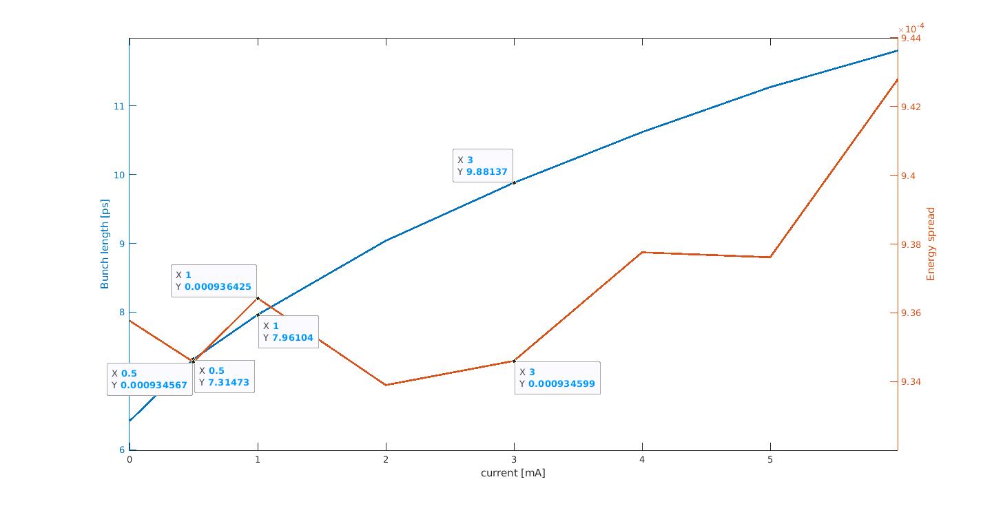

Dear Michael,

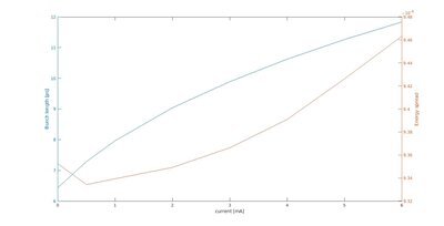

Thanks for your help. Finally, I increased the impedance budget and the resistive wall effect to achieve the logical behavior. But there is a question based on the result as I don't have the continuous increase in the energy spread, can I say that 2(mA) is a threshold current? and is it acceptable that I do not have smooth behavior in the energy spread?

- Posts: 2068
Re: Implementation of bunch lengthning and transverse impedance
Sara,
I'd suggest using more particles and finer spacing of the points in current. I'd hope that will give a clearer threshold.

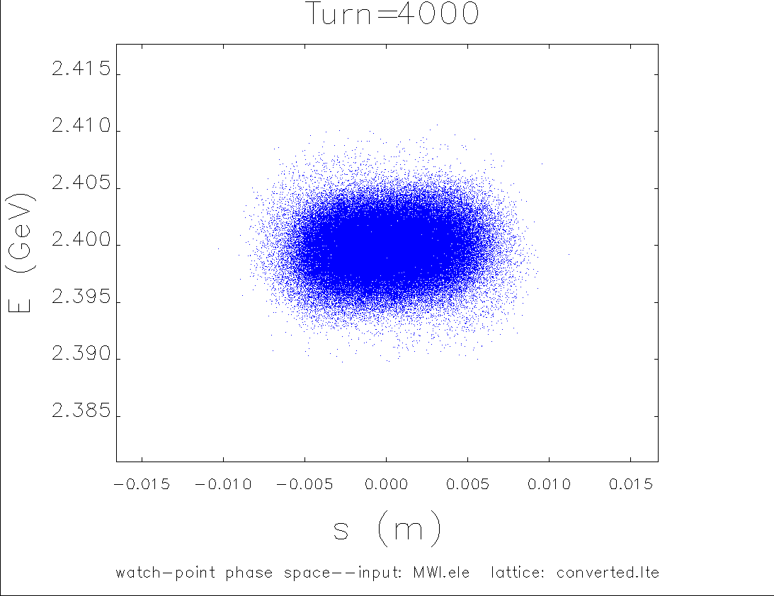

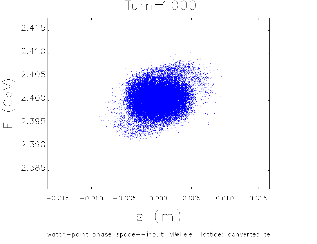

Thanks Michael. I will try your suggestion. I have another question, I have some kind of handle in the bunch length during tracking. Can we consider them as microwave instability and is it usual that they disappear after some turns?
1000 Turns with 2 mA currents 4000 Turns with 2 mA currents

- Posts: 2068
Sara,
Unless the handles reappear, I wouldn't consider that MWI. It may just be the bunch settling into the rf bucket that is distorted by potential well distortion.

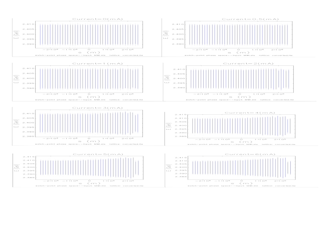

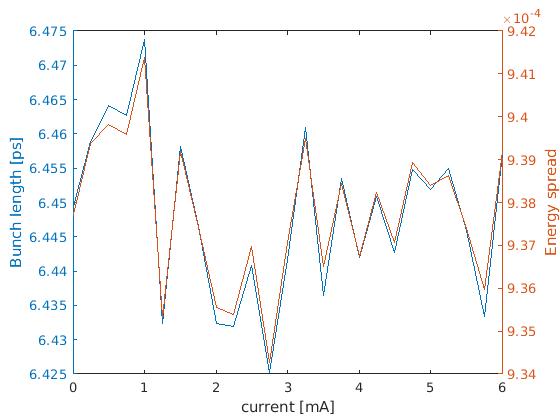

Dear Michael,

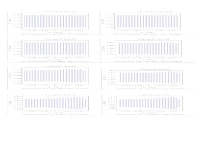

Thanks for the help. I increase the number of particles from 150,000 to 1,500,000 and it worked:) as below: Based on the result can I announce 0.5 mA as the threshold current? Also, I try to know how the beam behaves in MWI. For this, I plotted t,p from the watch file for each current as below in different steps. Is it correct if I consider the change in the behavior of the beam in the plot as MWI? Regards,
