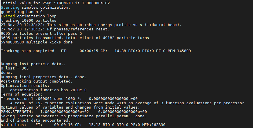

After setting FIRE_ON_PASS=0, the injection tracking works fine. By hit and trial method I found a best sextupole strength of 360 1/m2. However, while I do an optimization run, it gives the output: optimum strength equals to initial guess only. Where I am doing mistake, can you please help me out. I am attaching the output screenshot and relevant input files. Also, how can I plot the phase space data for each turn separately with different color or mark. The command "sddsplot psminjection.w1 -column=x,xp -graph=dot" gives a plot of every turn data together in which I can't distinguish each turn phase space.
Thanks and regards
Saroj Jena

- Posts: 2051
Re: Injection optimization
Saroj,
I made a number of modifications to your files. Please see attached. There are some comments added to the files to explain what I did. The script 'runScript' will run the whole thing, but it assumes you have 18 cores available so you may need to edit it.
One issue is that there's a bug in the parallel version in that the Transmission quantity used by the optimizer isn't correct. I used nLost instead, which gives the number of lost particles.
For plotting, you need to split the file into pages in order to get different colors, e.g.,
There's an example in the runScript file.
Code: Select all
sddsplot -split=page -graph=dot,vary -col=x,xp filename.sdds

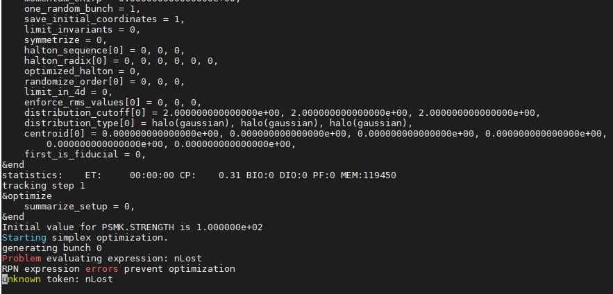

Thanks Michael for quick reply. I could understand many things from the comment lines..
However, the suggested nLost in optimization routine is giving error. please find the screenshot of the error message.
With best Regards
Saroj Jena

- Posts: 2051
Saroj Jena,
Can you verify that you are using the latest version of elegant (2020.4)?
Saroj_Jena
- Posts: 13
- Joined: 16 Nov 2020, 08:34
Actually I was using elegant version 2019.1.1, in which it was giving error. Now I used latest version 2020.4 in which the optimization using nLost is working fine.
