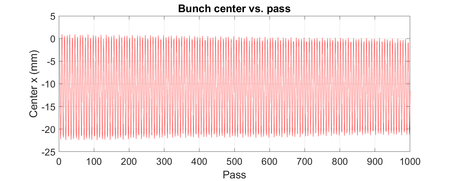

I'm trying to simulate the transverse y impedance using the ZTRANSVERSE command with BBR in a simple beamline model. The model includes elements like ILM, SREFFECTS, RFCA, and an impedance element (LST files attached). However, I'm encountering a large amplitude in the Cx value that I can't eliminate. The center position and angle have no offset and are zero, and the impedance is defined as the y-direction, so I think the question is rather why it vibrates so much in the x-direction?

I think the problem is just that you set X_DRIVE_EXPONENT=0. That means that the horizontal wake is a monopole wake, so that there is a kick in the x plane regardless of x position. If you want to turn off the horizontal wake, set XFACTOR=0
