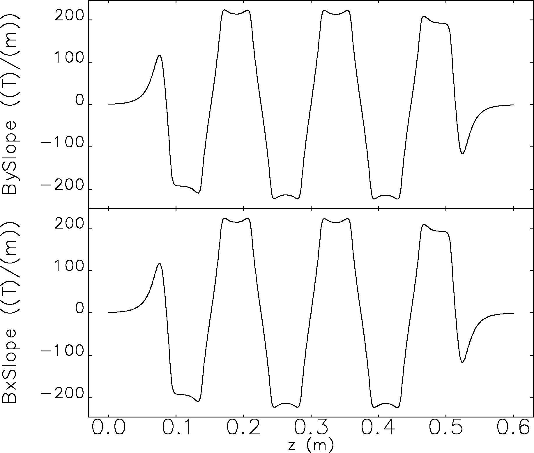

The problem seems to be that your field file does not define a quadrupole magnet. To check this, I computed dBy/dx at y=0 and dBx/dy at x=0 as a function of z.
As you can see dBx/dy=dBy/dx, when they should have opposite signs.
I guess if you change Bx-> -Bx it would be a start.
Code: Select all
sddssort fieldmap300.sdds -pipe=out -col=z -col=x -col=y | sddsbreak -pipe -change=z | sddsprocess -pipe -filter=col,y,-1e-6,1e-6 -process=By,slope,BySlope,functionOf=x -process=z,first,z | sddscollapse -pipe=in BySlopeVsZ.sdds
sddssort fieldmap300.sdds -pipe=out -col=z -col=x -col=y | sddsbreak -pipe -change=z | sddsprocess -pipe -filter=col,x,-1e-6,1e-6 -process=Bx,slope,BxSlope,functionOf=y -process=z,first,z | sddscollapse -pipe=in BxSlopeVsZ.sdds
sddsplot slopes -layout=1,2 -join=x -sep=1 -col=z,BySlope BySlopeVsZ.sdds -col=z,BxSlope BxSlopeVsZ.sdds

As you meant, the beam in a quadrupole focuses in one direction and defocuses in the other. This phenomenon arises from the forces acting on the beam, which are directed into or out of the magnet center, while the field gradient maintains the same sign in both the x and y directions, indicated by dBx/dy=dBy/dx.
I also referred to Helmut Wiedemann's book "Particle Accelerator Physics" fourth edition, page 104, for confirmation. According to the book, the magnetic field can be derived in Cartesian coordinates from the scalar potential V= -gxy. This yields,
-∂V/∂x = B_x = gy and -∂V/∂y = B_y = gx
Hence, I think, any disparities between codes should be attributed to other factors.
To define the issue more accurately, I should say, using the same field map I obtained β_x = 34 m , α_x = -25 , β_y = 130 m and α_y = 361 from BMAD and ASTRA at the end of the magnet structure while ELEGANT gives me β_x = 50.15 m , α_x = 0.27 , β_y = 100.84 m and α_y = 192.88.
Is there any way to track the beam and obtain (cross-check) the beam twiss parameters within the magnet?
