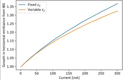

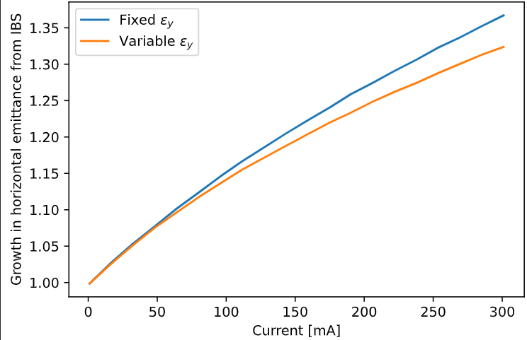

Thanks for putting that together. I compiled it, but I just want to check something please. Without using the new fixEmity command, I just wanted to check that they were the same. Is the discrepancy related to the bug you mentioned about using -emityInput? (For context, 'oldRunScript' uses ibsEmittance that shipped with elegant 2019.1.1; the new one is the one you sent me)
Code: Select all
$ ./oldRunScript; ./newRunScript
Input values:
emitxInput ($gp$rm) =  1.616545e-10  emityInput ($gp$rm) =  1.000000e-12  sigmaDeltaInput =      9.355127e-04
IBS-inflated values:
emitx ($gp$rm) =  1.090417e-10  emity ($gp$rm) =  1.090417e-10  sigmaDelta =      9.508862e-04  sigmaz (m) =      3.800854e-03
emitx (m) =   2.166084e-10  emity (m) =   1.339947e-12  sigmaDelta =  1.069316e-03  sigmaz (m) =  4.274238e-03
Comparing the results, it would seem that the latter makes more sense.
I plotted the difference between fixedEmit={1|0}, if you're curious:
So I think that was indeed worth the modification (thanks again Michael).

Yes, that's the bug you are seeing in the first set of results. It made the two emittances equal.
