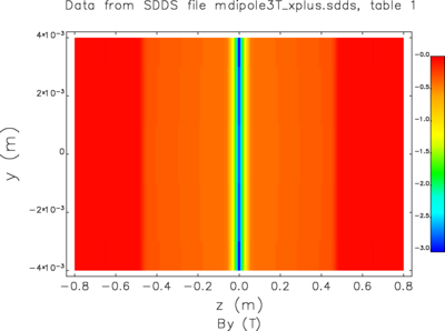

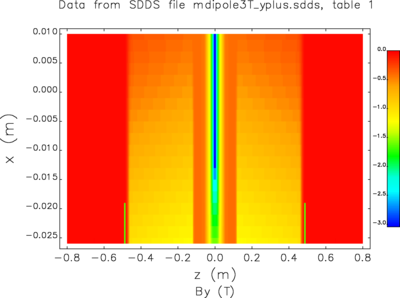

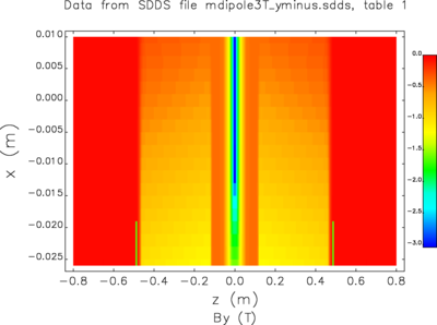

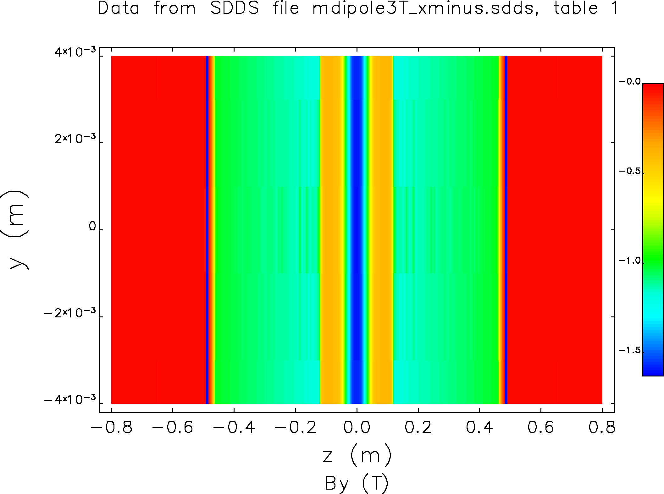

The problem is that the data was spread across multiple pages. You can fix this using these commands
Also, the x, y, and z data values appear to be in mm, but the definition is m. You can fix this with
Now you can plot the data as a check, e.g.,
However, the results look odd to me. See below.
There may be issues converting into SDDS. The program plaindata2sdds is a good choice for performing the conversion.

Code: Select all
sddscontour -shade -xyz=z,y,By mdipole3T_xplus.sdds

First of all, many thanks once again for your help that allowed me to set up a procedure (using the SDDS commands you indicated) to prepare the SDDS data files needed. I finally managed to make the GGE decomposition with the magnet data set that you saw.
In doing so, I used the option -autotune=${mag3Ddata}.sdds, minimize=rms with the original 3D volume magnetic field data I got from my magnet colleague as ‘mag3Ddata’.
The results I got on the GGE decomposition output files ('***.gge) for normal and skew components both showed that the multipole value is limited to m=2 and no multipoles higher or equal to sextupole are given. I first thought that this is due to the too coarse grid of 2 mm that I used, so I asked my colleague to reduce the grid size to 0.25 mm, which was also the value I saw in the example case you provided in "ccbend1". Repeating the whole procedure with the new datafile, however, the limitation in 'm' remained the same, though I did see overall improvement in the fit level.
So, I wonder if the limitation in the m values (and in d values as well I think) comes from the fact that the 3D rectangular volume in my case is defined in a non-symmetric manner with respect to x = 0, as you very well pointed it out by showing me the four colored plots of By. Showing those plots to my magnet colleague, I could confirm that they are correct. However, as you saw he defined the horizontal extension to be -0.026 m <= x <= +0.010 m. So without any further specification, I suppose the GGE is done at x = -0.008 m instead of x = 0. Since the treated magnet is a transverse-gradient dipole on the outer parts and a longitudinal-gradient dipole at the center, we cannot make the GGE along the beam trajectory which is curved. However I suppose that the GGE better be done on an axis which is closest to the curved trajectory. Here I wish to have your opinion. I saw in the elegant manual that one could also define the decomposition axis using 'xCenter' and 'yCenter'. However, these parameters do not seem to appear in the description of 'computeRBGGE' so please let me also ask you if there is a way to do so without redefining the rectangular boundaries.
I thank you very much in advance for your help.
