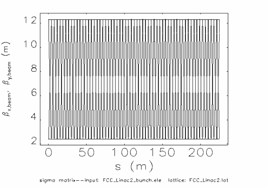

I did some tracking simulations along a linac using bunched_beam. My line is a FODO with some RF cavities, so I computed the optics to have periodic beta and alfa, and all was working.
Now I would like to simulate the same line, but using sdds_beam, because I can have a better representation of the beam longitudinal phase space.
For the optics I used sddsmatchtwiss from the distribution at the entrance of my line:
sddsmatchtwiss elegant_distr.sdds distr_matched.sdds -xPlane=beta=2.398316000894728e+00,alpha=5.018045512606445e-01 -yPlane=beta=1.230486994429303e+01,alpha=-2.328639432567440e+00

The problem is that the Twiss parameters are not what I expect.
The questions are:
- Is there a simple way to match also the emittance of the distribution like it is done for the Twiss functions, or should I do a script to do it taking the particles? (I have a smaller emittance now that before, because some margin was added for the emittance);
- Any idea of why I see this strange behaviour of the optics? Did I misunderstand anything?

What beam distribution did you use as input to the sddsmatchtwiss command? In particular, since rf cavities are involved, does it have the right energy, energy spread, and duration for input into your beamline?

I changed the distribution I applied the matchtwiss, and I repeated the full chain.
Now I used the command:
sddsmatchtwiss Linac1.out distr_matched.sdds -xPlane=beta=2.398316e+00,alpha=5.018045512606445e-01 -yPlane=beta=1.230487e+01,alpha=-2.328639e+00
When I analize the obtained beam:
sddsanalyzebeam distr_matched.sdds dd.txt
sddsprintout dd.txt -col=betax -col=betay -col=alphax -col=alphay
I obtain:
betax betay alphax alphay
m m
2.396964e+00 1.229089e+01 5.015092e-01 -2.326002e+00
The numbers are slightly different. To be sure, I changed them in the file where I use bunched_beam to start from the same conditions, and verify that this was not the problem, and this is not. I still have different plots of the beta. I attach also this file: FCC_Linac2_bunch_0.ele.
I attach the distribution:
- Starting distribution: Linac1.out
- Obtained distribution: distr_matched.sdds
and the relevant file to do the run:
FCC_Linac2_bunch.ele, FCC_Linac2.lat, and the wake files: case using the distribution from the file
FCC_Linac2_bunch_0.ele, FCC_Linac2.lat, and the wake files: case using the .ele file to generate the distribution

Simona,
The problem seems to be some confusion about filenames from several different runs. I made a few modification to your files and it works as expected. There is a mismatch that develops further down the beamline, but I suspect that is due to energy spread and chromatic effects. Another small issue is that sddsanalyzebeam by default does not remove energy-betatron correlations when computing the beam beta functions. Adding the -correctedOnly option forces it to do that, showing that the sddsmatchtwiss operation works as expected.
Code: Select all
Nominal starting twiss functions
m m
Beam starting twiss functions
m m
