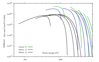

Dear experts,
I want to get a picture like the attached document about brilliance generated by 3 types of undulators.
To get this graph, I need to set Beam energy , Beam current, Horizontal emittance, Emittance coupling, Undulator magnet fields.
I found in the manual that the sddsbrightness command can be used for brightness mapping.So I use the tswissfile corresponding to the required lattice, using the following commands
sddsbrightness wu.twi run.bri -harmonics=5 -Krange=start=0.2,end=2.2,points=100 -current=0.1 -totalLength=3 -periodLength=0.040 -coupling=0.1
But the sddsbrightness command does not have the set of Beam energy, Horizontal emittance, Undulator magnet fields.How should I set these three parameters to be the same as the required parameters?Do I need to use other commands?

Hexin,
The beam energy and horizontal emittance are taken from the twiss file (wu.twi in your case). The undulator magnet field is set by the Krange parameter. Recall that the peak magnetic field is B[Tesla] = K/(93.4*lambda[m]), where lambda is the period length.

Dear Michael:
If I need to set undulator's magnetic field value to a fixed value T, then what relationship should I follow among Krange's start value and end value and T?
