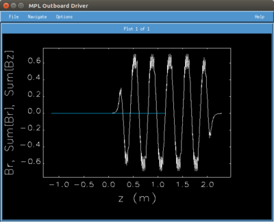

Re: transverse gradient undulator
Michael,
Thanks! It works with the alpha.rpn.
But there are still errors:
computeGeneralizedGradients -input field.sdds -output GG -mainHarmonic 4 -nHarmonics 5
warning: (z, Bz) does not appear in GG.ref
1 of 1 datanames absent from file GG.ref
warning: no datanames in request found for file GG.ref
Warning: not all y quantities have the same units
And the plot attached is also wird: the range of z should be from 0 to 2.3 m, I don't know why there is negative part.
Ji
Ji
- Posts: 2057
Ji,
I noticed a few problems: (1) You have multiple values of R. You should only have data for a single radius, e.g., 10mm. (2) You don't have many points in z; much finer spacing is recommended.
I'm putting together an example that may help. I might also need to modify the script to do this case, which we haven't done ourselves.
Michael,
Thanks a lot, that would be very helpful.
I use single R and much small intervals in z (stepsize 0.00023m), and it shows the same error message.So I am looking forward to the example.
Ji
