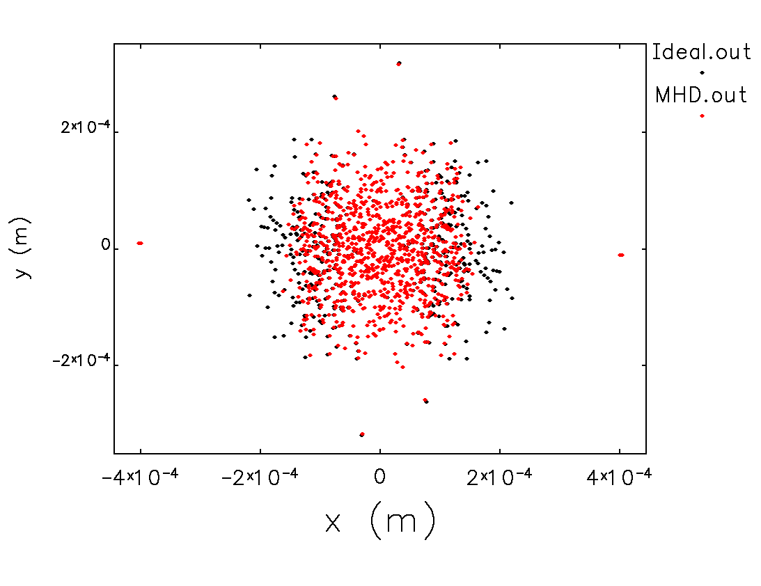

Hi Michael,
I tried to get rid of all errors by using your quad-test example and carefully recalculating my ftable ;)
It now produces results which look as expected. See the attached plot. Ideal is an ftable file of an ideal plasma lens and MHD is a nonlinear plasma lens. Some particles don't het the field (it's only 0.5mm square). Thank you for your help and quick replies!
Cheers,
Jan

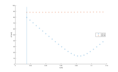

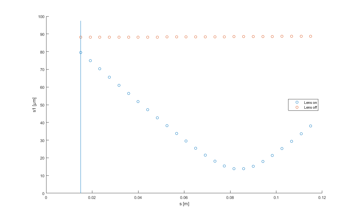

thanks again for the help. I used FTABLE with the old input some more and simulated passage through a radially symmetric field. The field is 15mm long (z), and 250µm by 250µm (x and y). It gives the expected results except for a kick at the end of the lens. I plotted s1 over s from my .sig file and saw this. Then i plotted with a scatter plot and saw what's in my attached BeamSize plot. So the FTABLE element seems to have no division. I have KICKS = 400 and element_division = 32. How can I divide the field? Or is this some artefact of the definition of s since it is the distance travelled by individual particles?
Many thanks again and kind regards,
Jan
Example.ele
(1 KiB) Downloaded 632 times
Example.lte
(592 Bytes) Downloaded 621 times
s1 versus s for FTABLE FACTOR = 1 and 0.

Post by michael_borland » 28 Jul 2016, 10:34
Jan,
Unfortunately, FTABLE elements can be readily divided. You'd have to divide the field file and make many elements.
I'll think about how this might be included as a program feature, but it won't be straightforward.
