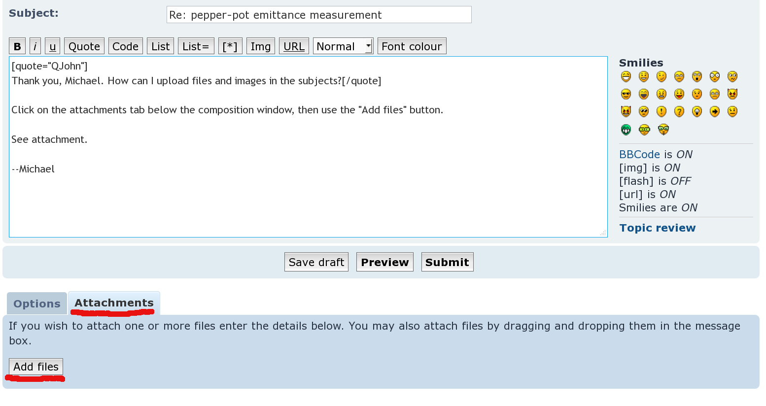

Thank you, Michael. How can I upload files and images in the subjects?

QJohn wrote: Thank you, Michael. How can I upload files and images in the subjects?
Click on the attachments tab below the composition window, then use the "Add files" button.
See attachment.

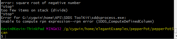

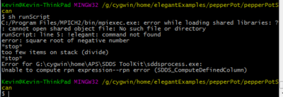

Than you Michael, I now have three quuestions,
1. I can't do parallel computation,the erros as follows:
2.When I do'nt use the parallel computation, I follow your advice and add two parameters alphax=0 and alphay=0 in .ele file, meanwhile, I output the results when the electron beam reached the pepperpot plate. But I also get the following erros:
the output files I before.out and before.sig which I added in the .lte file are too large , about 14GB. The accessory is the elegant files. Can you help me to optimize it? Than you very much!
The attachment 1.PNG is no longer available
The attachment 2.PNG is no longer available
pepperpot.zip
(154 Bytes) Downloaded 379 times

Post by michael_borland » 10 Dec 2015, 12:47
The zip file is empty.
QJohn
Posts: 19
Joined: 08 Dec 2015, 10:49
Re: pepper-pot emittance measurement
Post by QJohn » 10 Dec 2015, 20:07
michael_borland wrote:The zip file is empty.
Sorry, Michael, please check out the accesory again.
pepperpot.zip
(1.52 KiB) Downloaded 409 times
QJohn
Posts: 19
Post by QJohn » 10 Dec 2015, 20:16
Hi, Michael, I don't know weather you can see my questoins which I pointed out before by pictures . I now repeat my questions again:
the output files I before.out and before.sig which I added in the .lte file are too large , about 14GB. Can you help me to optimize it? Than you very much!
Posts: 2057
Joined: 19 May 2008, 09:33
Contact:
Post by michael_borland » 12 Dec 2015, 16:38
The root of all the problems is that the beam is not upright in phase space at the entrance to the RCOL element. This causes the computations to fail because it violates one of the assumptions of the pepper pot method. When the calculation produces an invalid value (square root of a negative number) that subsequently generates the error about too few items on the stack.
You put alpha_x=0 and alpha_y=0 in the &bunched_beam command, but that controls the beam parameters at the start of the simulation, not at the entrance to the pepper pot plate. Look at the before.out file and you'll see that the beam is a tilted stripe in (x, x') and (y, y') phase space. The pepper pot method won't work in this case. If you tune the two quadrupoles to give the required conditions alpha_x=0 and alpha_y=0 at the entrance to the RCOL element, it should all work fine.
