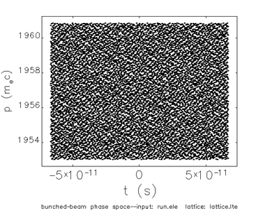

Thankowat,
Sorry, my mistake. You should use the "hard-edge" distribution type, not "uniform". "uniform" is simply short-hand for "uniform-ellipse".
Example attached.
Example attached.
Code: Select all
% elegant run.ele
% sddsplot -column=t,p run.bun -graph=sym,fill
