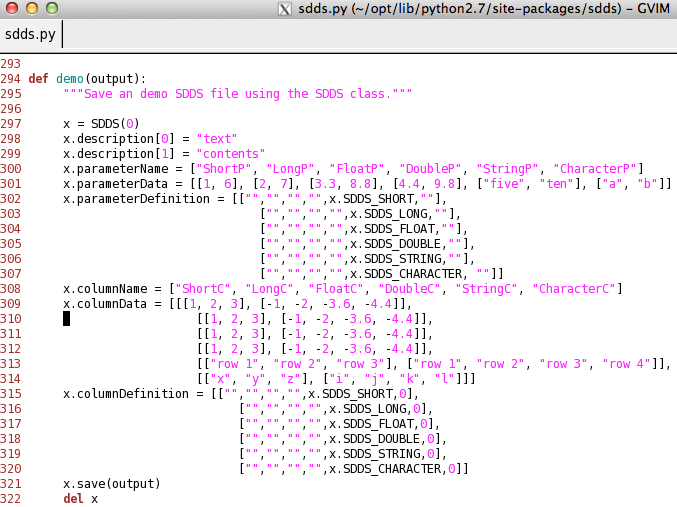

The LongC column data is wrong - it shows up as 1 0 2 not 1 2 3, and -1 -1 -2 -1 not -1 -2 -3 -4. Everything else makes sense though.
This is the code for the demo function:
