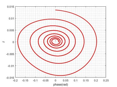

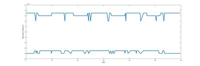

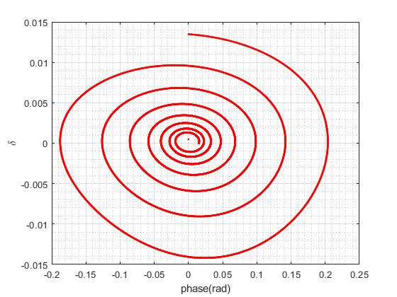

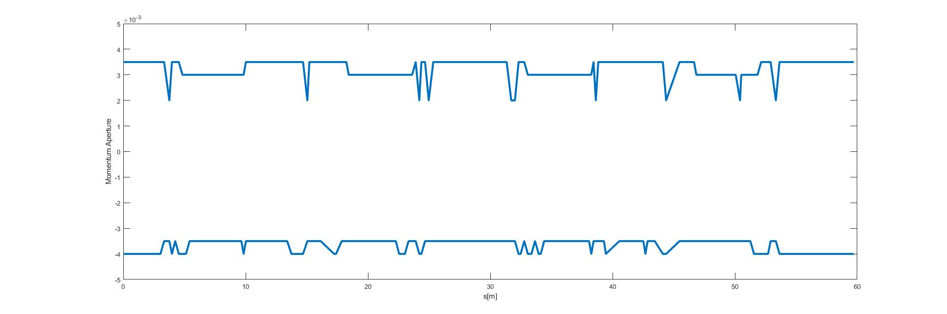

I want to tracking the Momentum Aperture for a lattice without sextupole to simulate the machine beam-tuning process.Without the sextupole,the chromaticity【dnux/dp (1/(2$gp$r)) = -2.159890e+02】and 【dnuy/dp (1/(2$gp$r)) = -2.921960e+02】 are so big!I used one particle tracking(by using the MALIGN element to set the initial DP),I get the particle with dp/p=0.013 could be survived for 10000 turns.But with the momentum_aperture command,I got that the deltaPositive is smaller than 4e-3,Particle lost with delta0 = -5.000000e-03.In the momentum_aperture command,I set forbid_resonance_crossing=0.
I used Accelerator Toolbox for the same lattice particle tracking,the particle with dp/p=0.013 could be survived for 10000 turns too!

I follow your advice to check all the settings,I found there is one point where the settings is different.In one particle tracking model,I set the MALIGN element with dx=0,dy=0 and dp=0.013,but in the momentum_aperture model,I set x_initial=1e-6,y_initial=1e-6.I think in the momentum_aperture tracking model,the ELEGANT using NAFF method to get the tunes,so I set a initial x or y offset,it may help to get the tunes.When I set x_initial=0e-6,y_initial=0e-6,the deltaPositive got from the momentum_aperture model is almost same like the one particle tracking model.I don't know why the Momentum Aperture is so sensitive to the initial offset(I think x_initial=1e-6 is small enough).
