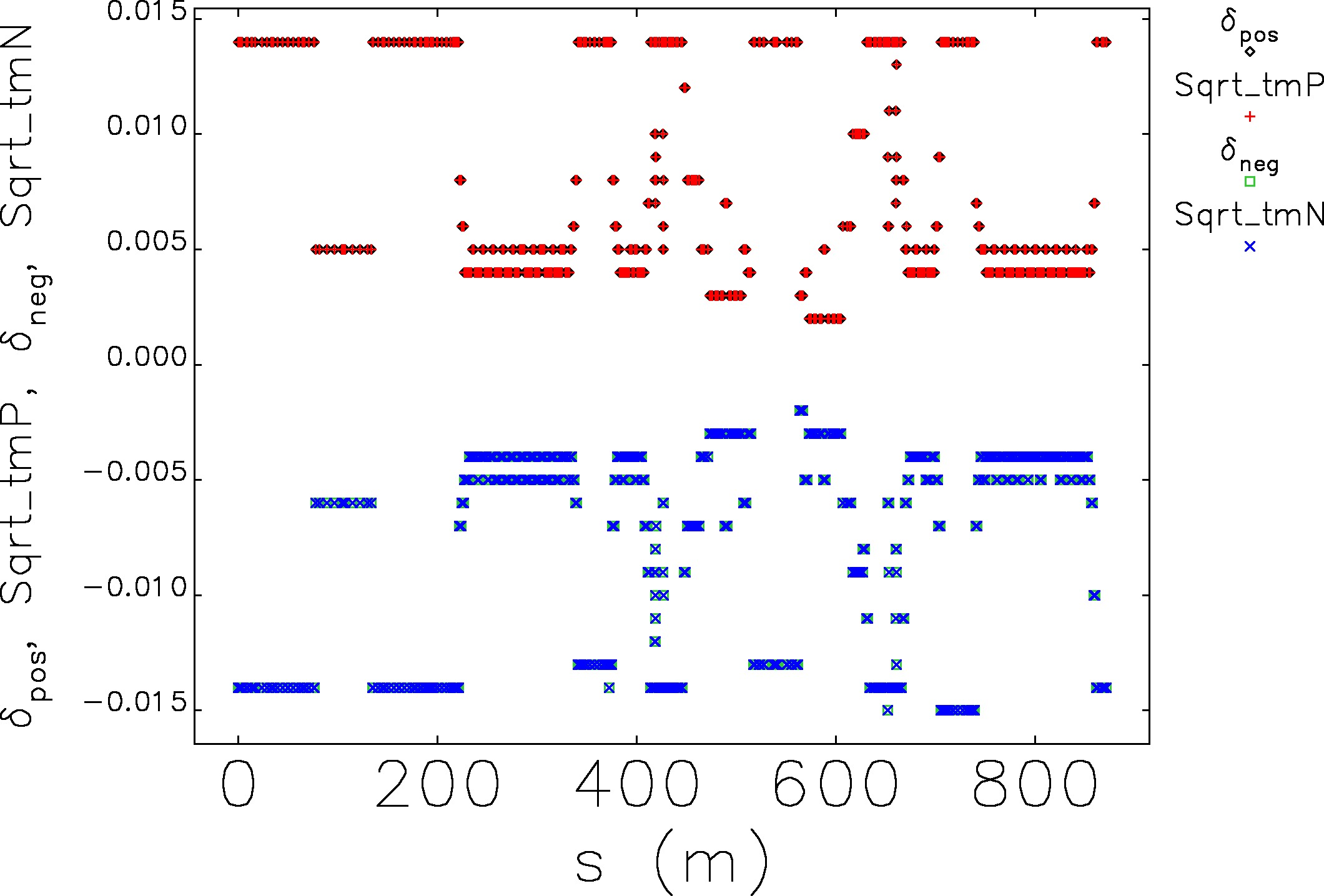

I calculated momentum aperture, ibs emittances with ibsEmittance and Touschek lifetime with touschekLifetime.
Then I plotted momentum aperture and square root of tmP and tmN, which look different from momentum aperture on attached figure. The difference is clearly visible while comparing the mmap and tlife files. The number of elements is identical.
Why is the difference? It looks like there is a some type of smoothing.
The second question is an attempt to understand the loss rate plot. The peak at s=588 m has minimum of H and minimum of dispersion comparing with immediate surrounding. What is the reason for the peak?

I can't reproduce your results. For this energy, sqrt(tmP) and -sqrt(tmN) are deltaPositive and deltaNegative. If I plot those, the agreement is essentially perfect.
The FN and FP columns are misleading, since they are not integrated vs s. If you do that, the spike doesn't look so significant.
For this plot, I normalized FN and FP to the circumference, then integrated vs s, so the units are 1/s.
--Michael

It is puzzling. I read sdds files into python pandas and plot them. The difference is obvious.

and compare mmap and tlife for element and the difference is visible
L2.MQ23 (s = 8.198064599999999e+01)
in mmap: deltaPositive = 5.000000000000000e-03
in tlife: tmP =5.424767157239484e-05 and the square root is sqrt(5.424767157239484e-05) = 0.0073653018656668
R1.MQ20 (s = 4.444997969999995e+02)
in mmap: deltaPositive = 1.4e-2
in tlife: tmP = 1.575137583744795e-04 and the square root is sqrt(1.575137583744795e-04) = 0.01255044853280071
