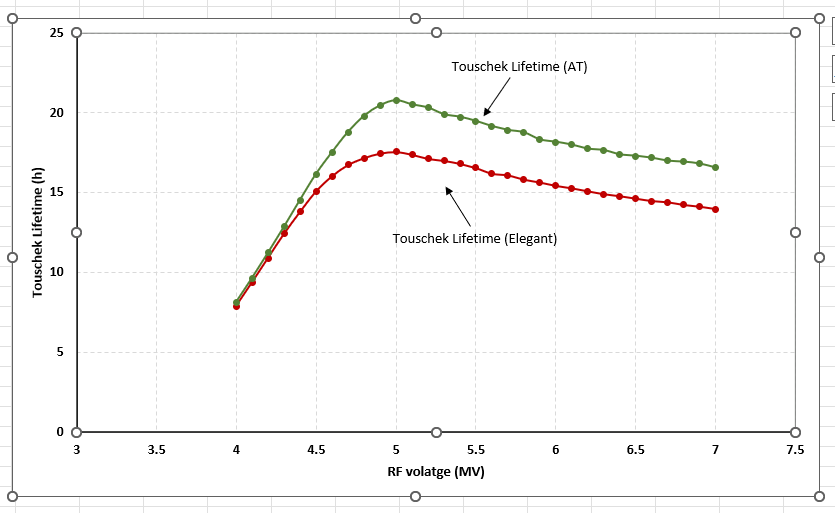

I calculated the Touschek lifetime for an example lattice using both Elegant and AT, and plotted the results for different RF voltages. I observe that the lifetimes obtained from the two codes show noticeable differences. From further analysis, I found that the momentum aperture computed in Elegant is lower compared to AT, which seems to explain why the Touschek lifetime predicted by Elegant is correspondingly smaller. I used element-by-element synchrotron radiation calculations in Elegant by enabling radiation locally using SYNCH_RAD = 1, ISR = 0 for the CSBEND, KQUAD, and KSEXT elements. I also placed rf cavities in the right location in the lattice, that too didn't resolve the discrepancy.
I have attached the plot showing the variation of Touschek lifetime with RF voltage.
