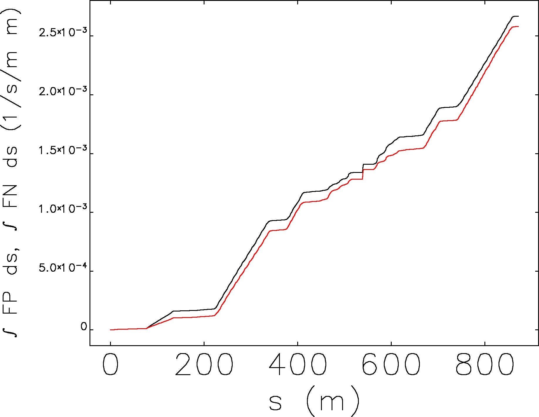

I can't reproduce your results. For this energy, sqrt(tmP) and -sqrt(tmN) are deltaPositive and deltaNegative. If I plot those, the agreement is essentially perfect. The FN and FP columns are misleading, since they are not integrated vs s. If you do that, the spike doesn't look so significant. For this plot, I normalized FN and FP to the circumference, then integrated vs s, so the units are 1/s.

Thank you, Michael,
It is puzzling. I read sdds files into python pandas and plot them. The difference is obvious.
I also converted sdds files into ascii (both files are in the new attachment)
and compare mmap and tlife for element and the difference is visible
L2.MQ23 (s = 8.198064599999999e+01)
in mmap: deltaPositive = 5.000000000000000e-03
in tlife: tmP =5.424767157239484e-05 and the square root is sqrt(5.424767157239484e-05) = 0.0073653018656668
R1.MQ20 (s = 4.444997969999995e+02)
in mmap: deltaPositive = 1.4e-2
in tlife: tmP = 1.575137583744795e-04 and the square root is sqrt(1.575137583744795e-04) = 0.01255044853280071
For this energy
beta=math.sqrt(1 - ((me_mks * c_mks * c_mks) / (e_mks * 1.5e9))**2 ) = 0.9999999419733219
and doesn't change much.
Even if I use sdds tools to create new columns sqrt_tmP and sqrt_tmN I still get the same results
I use SDDS_ToolKit-x64.msi version 5.1
Integration of FP and FN is a good comment. I will implement this.
Anton
