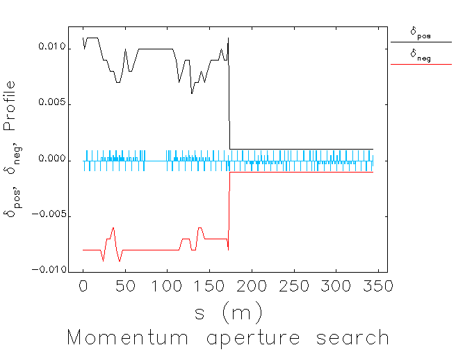

How to calculate the momentum aperture in a storage ring which has two central momentum values? Attached png is momentum aperture for the whole ring. The corresponding elegant run file and lattice file are attached.

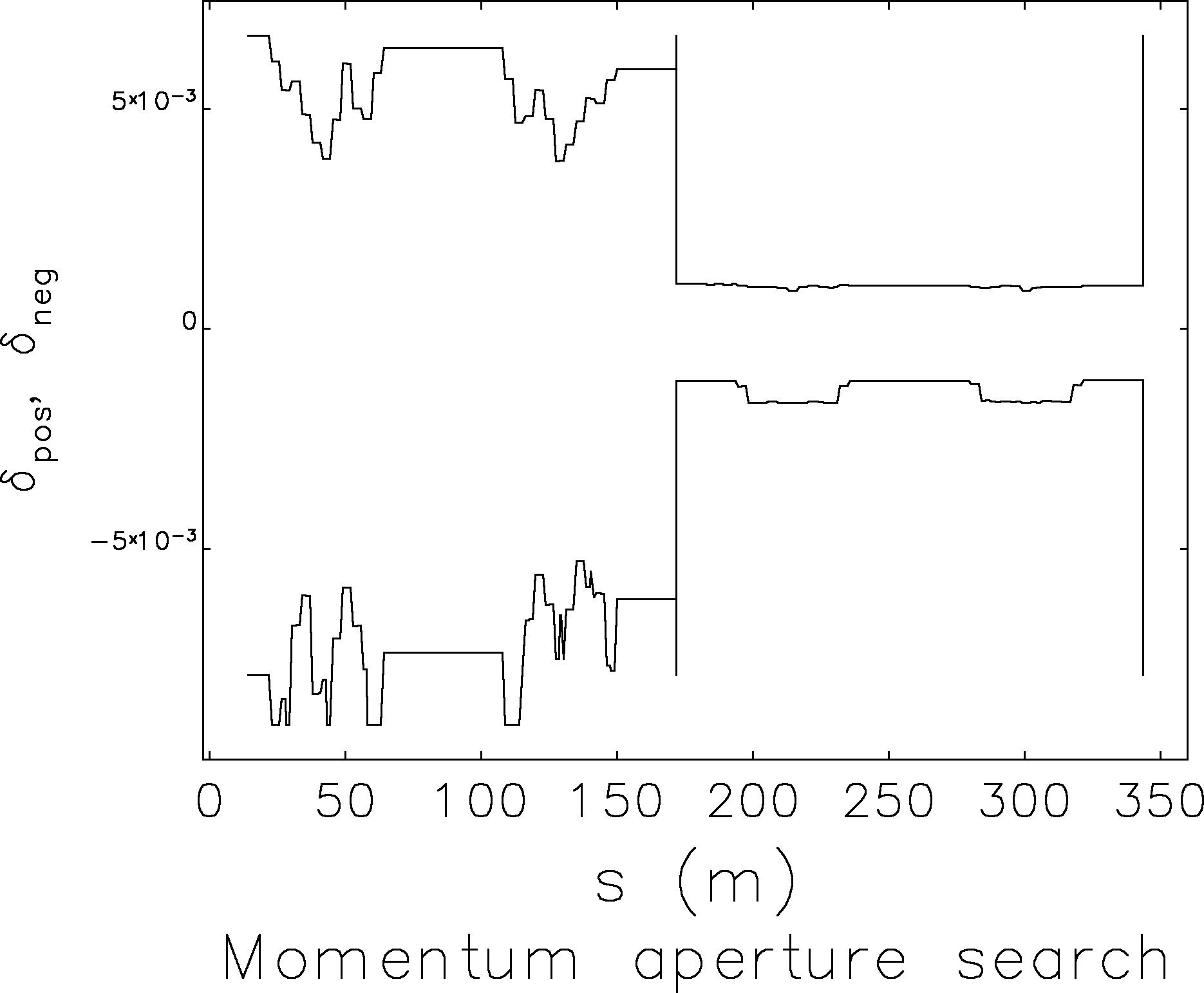

Bhawin,
I modified your input file (see attached) and get a somewhat different result, though the character is similar. I think this is a correct result, because the accelerating and decelerating cavities should, respectively, decrease and increase the momentum spread. So a particle that is given a momentum offset of, say, 1% in the high-energy section will see that turned into a bigger fractional offset in the low-energy section. (It's not quite that simple because of momentum compaction, which changes the arrival phase at the cavities according to the fractional momentum offset.) Hence, the high-energy section will have its fractional momentum acceptance reduced by the ratio of the energies, if all other things are equal.

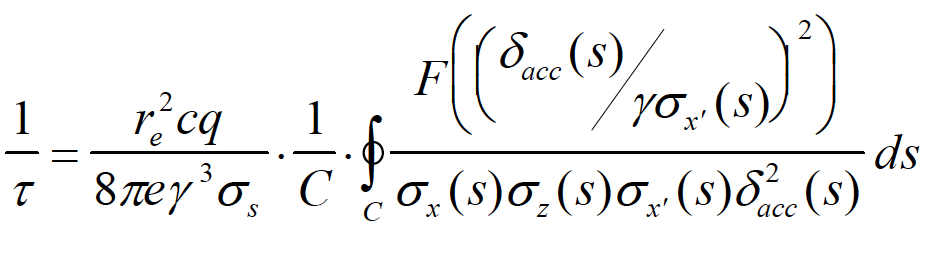

I also calculate Touschek's lifetime for each rings using the formula (see attached png) but there is a discrepancy in calculated values and elegant given values for Touschek's lifetime.
Am I doing the right way? Or there exists some special techniques to calculate Touschek's lifetime in two-energy storage ring. Since, two-energy storage ring has two different p_central values.

Thank you so much for your reply. Now I am able to get Touschek's lifetime for each ring. I have used the analytical formula (formula attached in the previous post) to calculate the lifetime in each ring. And also I use ELEGANT to calculate the corresponding tLifetime for each ring. The Touschek's lifetime calculated using the analytical formula and ELEGANT (touschekLifetime ler.life -twiss=ler.twi -aper=ler.mmap -particle=6.9E10 -coupling=0.05 -length=25...) agrees well for low energy ring case. But in the high energy ring part, there is a discrepancy in Touschek lifetime values using analytical formula and ELEGANT method (discrepancy almost by a factor of 2).
As you mentioned before, I have redefined pCentral, ex0 and Sdelta0 in the high energy ring twiss file. Then the corresponding twiss file and mmap files are used to calculate the tLifetime in high energy ring using ELEGANT. I am unable to figure out the discrepancy in high energy ring case.

I solved the problem. I need to reset 's' column in the high energy ring twiss file. The integration function otherwise takes the values ranging from 171.7 to 343.4 m in the high energy ring that giving the factor of '2' difference in Touschek lifetime. After doing that, 's' column in the high energy ring twiss takes the values ranging from 0 to 171.7 m. Resetting is done using sddsprocess as:
sddsprocess her_ring.twi -redefine=col,s,"s 171.7 -*"
Thank you so much.

And you formula is different from the formulat in ELEGANT, how much difference between the two results?
