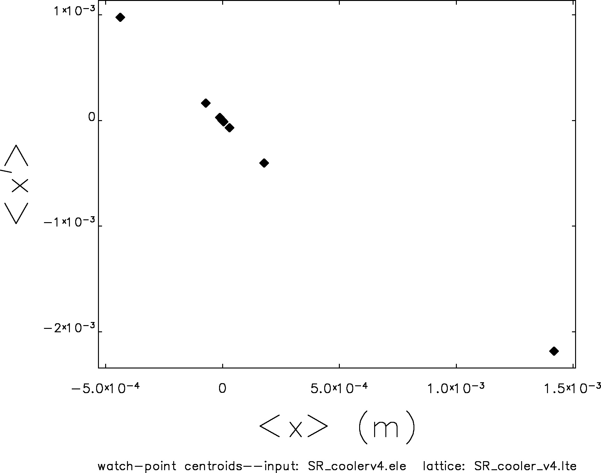

As you suggested, I modified the lattice to avoid those resonances. Now I have two energy loops, each of them having same length (~ 1740 m ). I decided to work with the artificial damping element ( SREFFECT).
For my system, two rings with the same energy (i.e 155 MeV ) with sr effect, particle is stable. But when I use two rings at markedly different energies say 55 MeV and 155 MeV , I have to use two cavities one for accelerating and the other for decelerating. In this case, with the use of sr element, no particle is present after a single pass.I think there may be some thing wrong with cavity set. For your reference, I have attached my elegant and lattice files.
Please give me some suggestions.
Thank you,
Bhawin

Bhawin,
I made some changes to your files to correctly set up the rf cavities. Search for "!!!MB" in the files to see what I changed. There's also a Notebook file with some explanations and plot examples.
There still seems to be an issue with a half-integer resonance in the horizontal plane. --Michael
