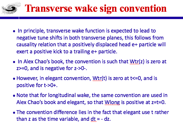

Dear Mina and Michael,

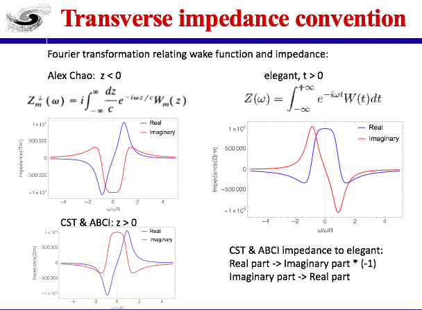

We did use CST to obtain the impedance and used Pelegant to do the tracking w/ impedance. I had a short note regarding the sign conventions, as shown in the attached files. I hope this helps.
Best,
Zhe

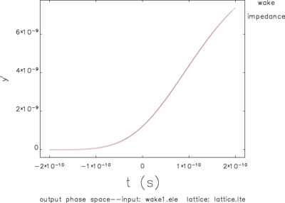

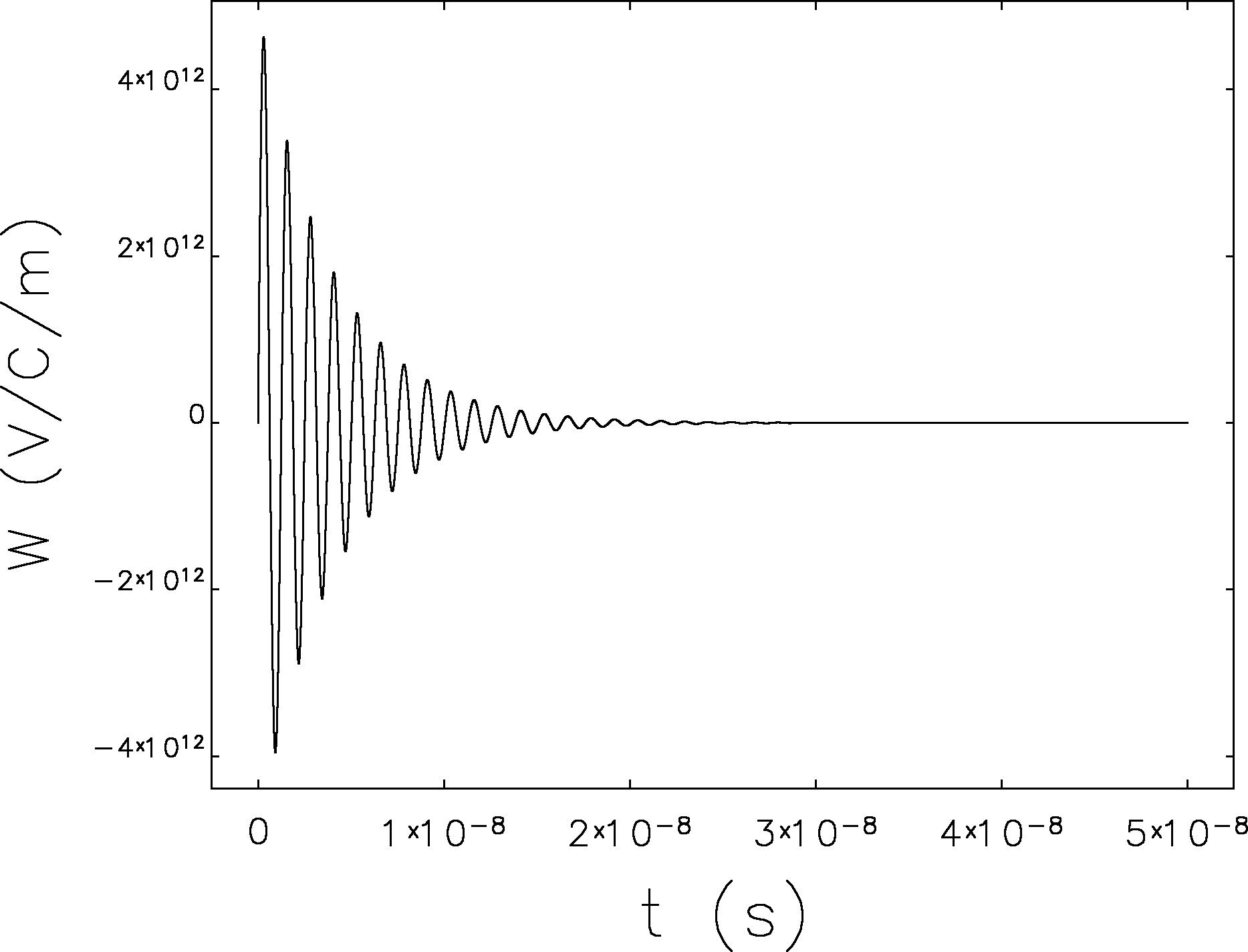

I've attached an example that shows the agreement between the wake/impedance formalisms and how to convert a wake into an equivalent impedance.
The wake is just a heavily-damped resonator

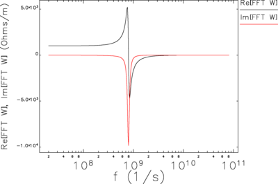

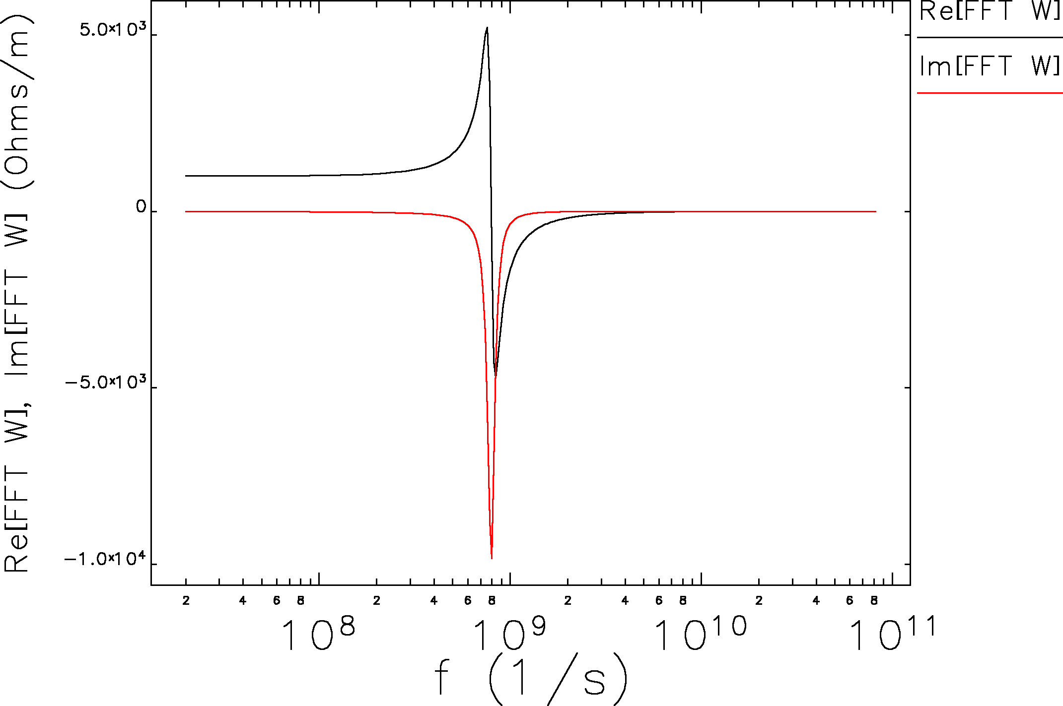

which has the following impedance

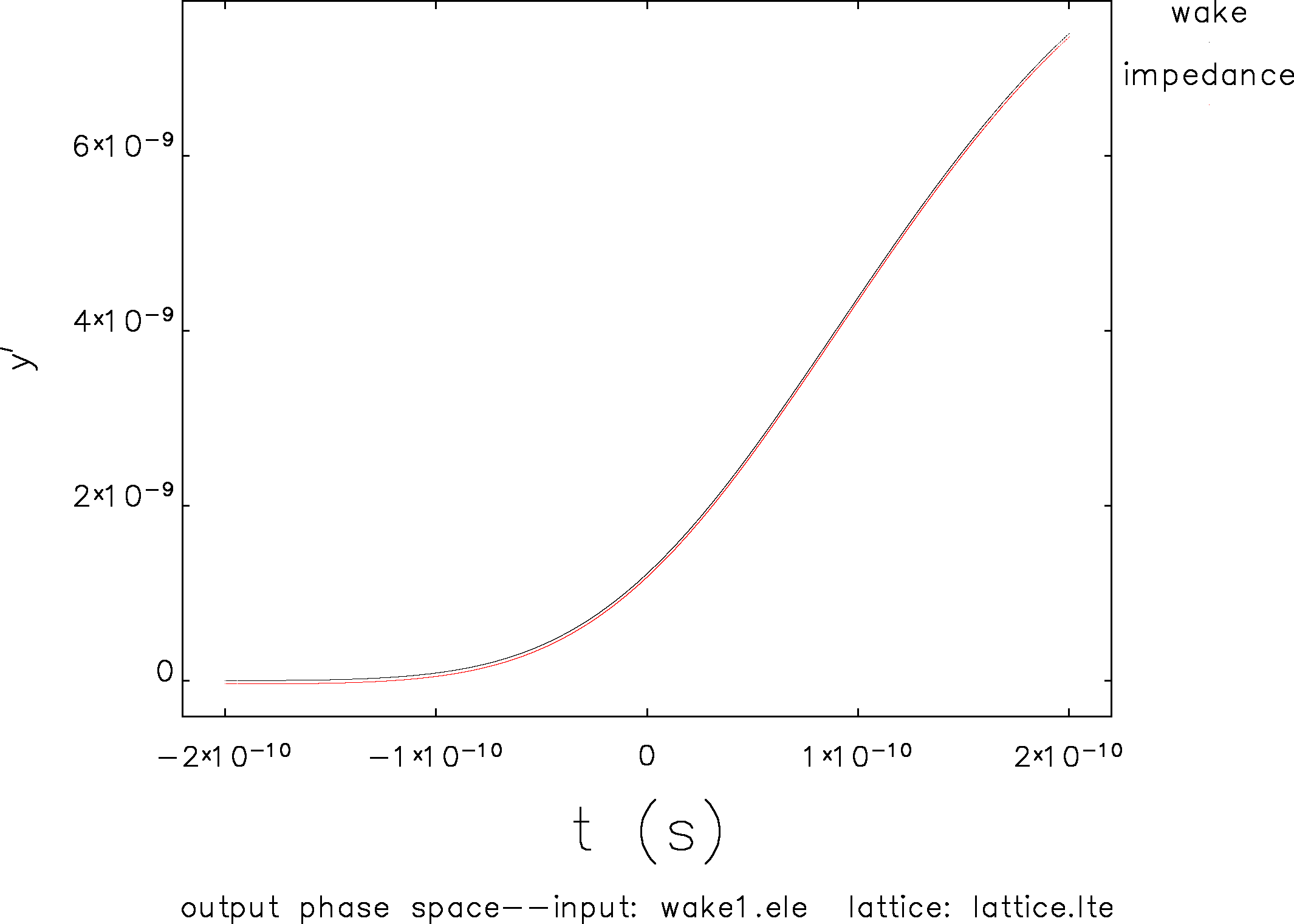

After tracking with each, I get a time-dependent deflection that agrees quite well

Actually, I rerun the sample you had provided and I realized that the main problem of my impedance file was insufficiency of the data points. When I used the option INTERPOLATE=1 in my lattice file in ELEGANT, the impact appears on beam dynamics.
Thanks to Zhe's comment, the other issue was the inconsistency between CST and ELEGANT impedance definitions. I considered the comment in my impedance data for transverse plane. Also for the longitudinal plane, there is a difference between CST & ELEGANT impedance definition which is described below.
CST longitudinal impedance to ELEGANT:
Real part -> Real part *(-1)
Imaginary part -> Imaginary part *(-1)
Including all mentioned points, I could see the same behavior in impedance and wake tracking.
