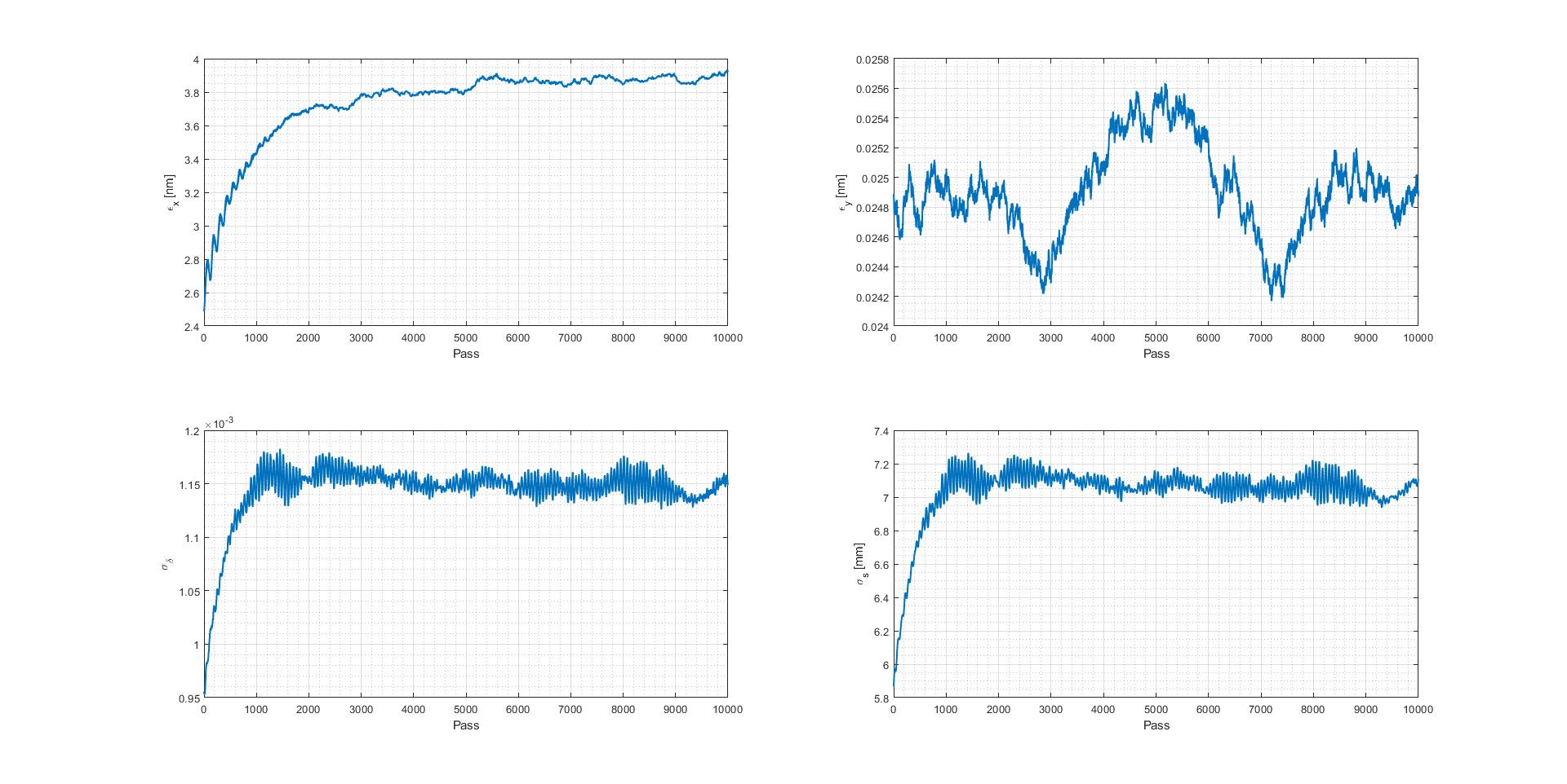

Dear all,
The attached file is the result of particle tracking with IBSCATTER and SREFFECTS(COUPLING=0.01),the emittance of y direction is not growing so much! If using the ibsEmittance command,the final emittance_y/emittance_x will be equal with the coupling factor.Should I add some tilt bends or quads in the lattice?
Thanks in advance!
Tiansk

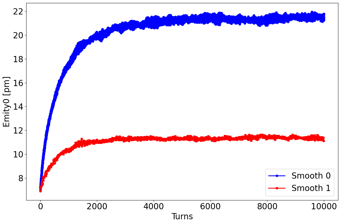

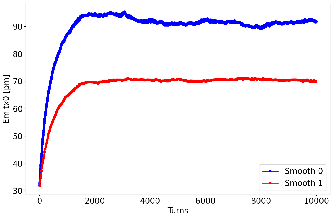

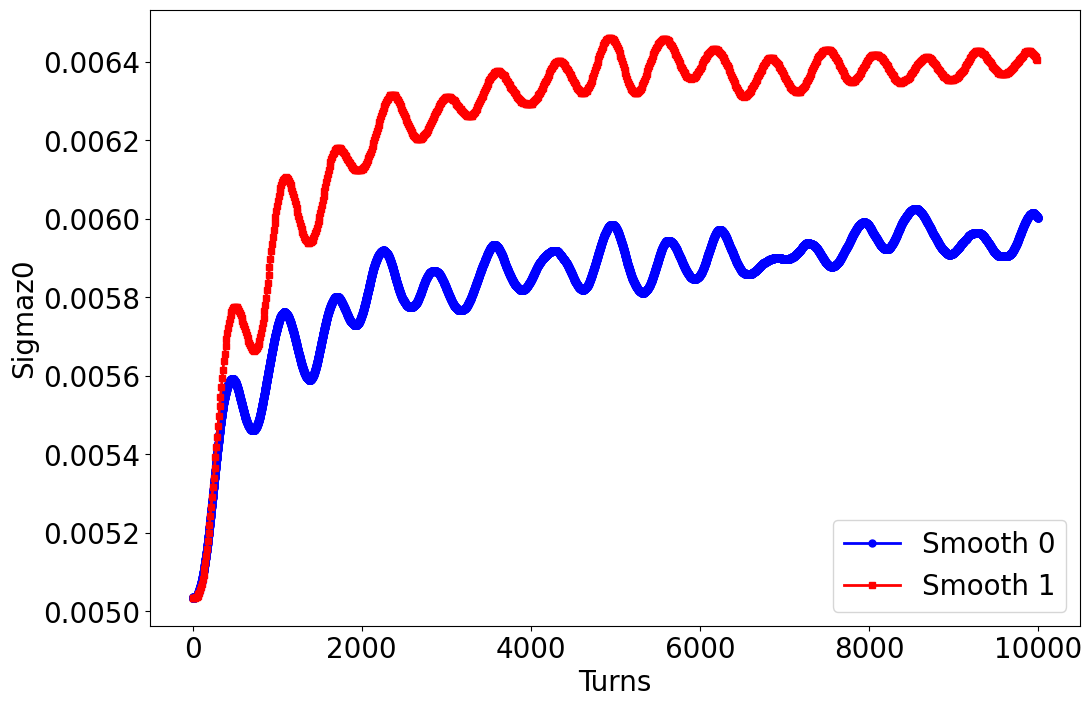

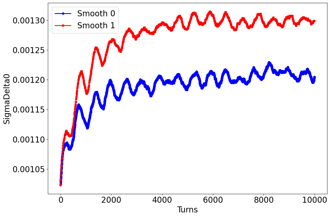

Dear all:
When using IBSCATTER to simulate the IBS effect, there is a parameter called SMOOTH in IBSCATTER. I believe that setting SMOOTH to 1 or 0 may result in different paths for the variation of beam parameters, but the final equilibrium state should be relatively consistent. However, after comparing the results with different SMOOTH settings, I found that the beam equilibrium state parameters differ significantly, as shown in the attached files. How can this be explained?
Thank you in advance,
Tiansk
Tiansk

The change in the vertical emittance is shown in the figure below.

Re: intrabeam scattering with IBSCATTER
Tiansk,
Could you provide your input files so I can check the results?
In general, I recommend using smooth=1 because otherwise you inject additional noise into the simulations.
