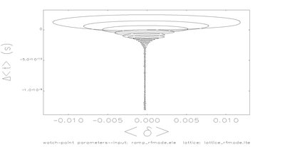

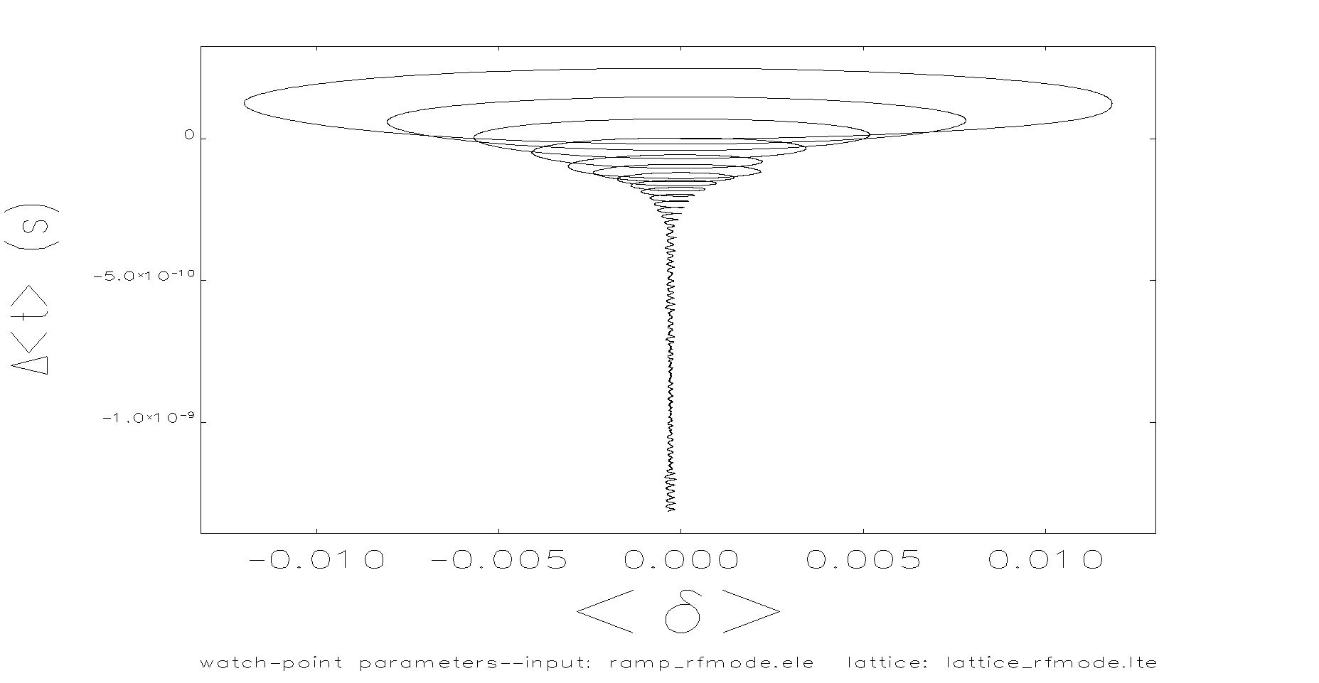

The result seems to be better,which could survive over 300 turns.However the beam loss energy after these turns.Here are my two more questions:
Best regards,
Jiang
- 1.From the *.rfm output of the tracking result,the RF feedback system doesn't seem to work very well.The voltage and phase of three cavity are changed a lot from the initial setpoint. Does it mean that the parameters of the feedback file *.sdds are not set correctly?
- 2.Besides that,I understand that the final beam induced voltage are decided by the average current and the tuning angle of the cavity.The quantities Phase in the *.rfm file,which described as the phase of beam induced voltage,is it have a rigorous relation with the tuning angle?

- Posts: 2062
Re: Confusion to the RFMODE element
Jiang,
If I use the RFCA elements in your lattice file, the beam is also lost. Adding up V*sin(phase) for all the cavities gives 4.38 MV, whereas the energy loss per turn is only 2.8 MV. This needs to be fixed before switching to RFMODE elements.
Once you've got the right voltages and phases, you'll need to decide how to detune the cavities, as they are presently all on resonance. Typically you'll need to detune by -10 to -20 kHz, but that depends on a lot of factors. You can use the TAPAs Android app to help figure out the matching and detuning (look for Main Cavity Beam Loading under Electron Storage Rings).
Even after doing that, you may indeed find that the loops are too slow. You can try to resolve this by ramping the current up more slowly, or adjusting the loop parameters. As I mentioned earlier, we tried to stabilize a three-cavity system for APS-U and never succeeded above 20 mA, so I expect this will be very challenging.
You can make your simulations much faster at this stage by switching to concatenated matrix-based tracking. It won't matter for now. See the attached file for how to do this. Also, you should switch off quantum excitation since you have only 1 particle per bunch. Set QEXCITATION=0 on the SREFFECTS element.

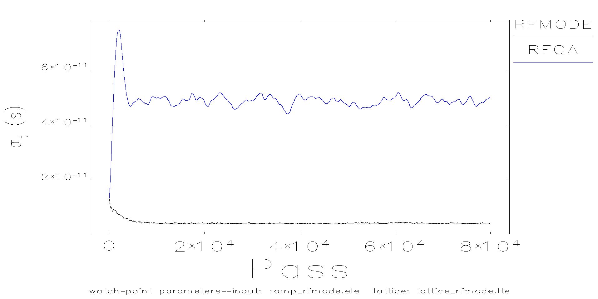

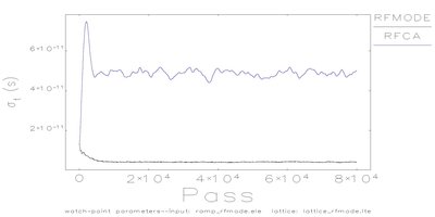

Hi Michael,
Thanks for your patient reply! We found an another problem that the bunch length calculated by the element RFCA and RFMODE are different.
The double rf system is detuned at 200mA under our main ring lattice.Near the optimal lengthening condition,the tracking result of bunch length is different from the calculation.Then we read the data "V" and "PHASE" from the passive cavity defined by RFMODE and track again utilizing the RFCA element,the bunch length is larger than prior result. Furthermore the dCt varies with Cdelta given by the RFMODE seems strange. Feedback system seems work well,and the file is in the attachment.
Best regards,
Jiang
