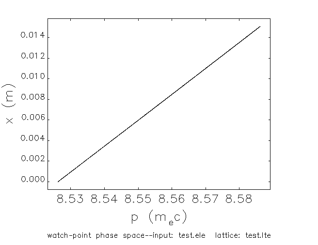

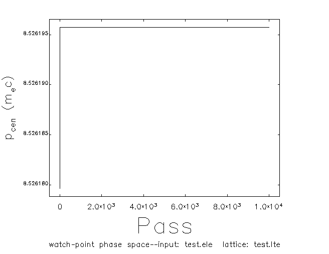

Here is what I get when I do: sddsplot w1.sdds -par=Pass,pCentral
or sddsplot w1.sdds -col=p,x
The offset grows with momentum, which means that the fields are not being scaled.
Can you help please? I tried many different options. It works okay in a storage mode but whenever I try to accelerate over multiple passes I do not seem to be able to update the reference momentum after the first pass.
