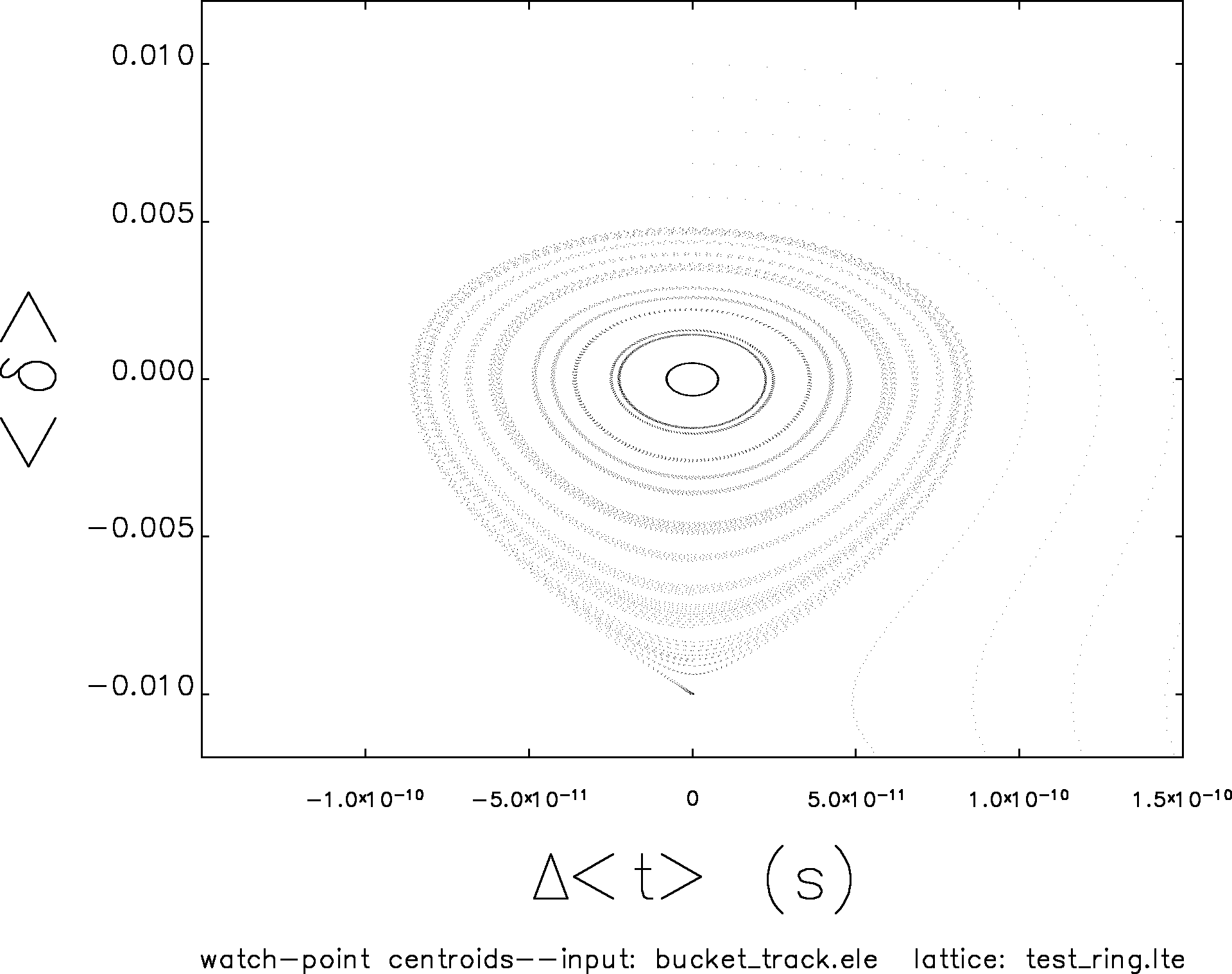

I am not able to plot alpha buckets using the command sddsplot indus2-x.w1 -col=dCt,Cdelta -graph=dot. For the sextupole (S2) strength 1.8, it is plotting the regular bucket but below the strength 1.8 (I took 1.7), where the alpha buckets should start appearing, neither the regular nor alpha bucket is getting plotted.

Abdurrahim,
The problem is that particles are lost, which requires some extra work on the plot command to see what you want.
Try
Try
Code: Select all
sddsplot -col=dCt,Cdelta indus2-x.w1 -graph=dot -scale=-1.5e-10,1.5e-10,-0.012,0.012

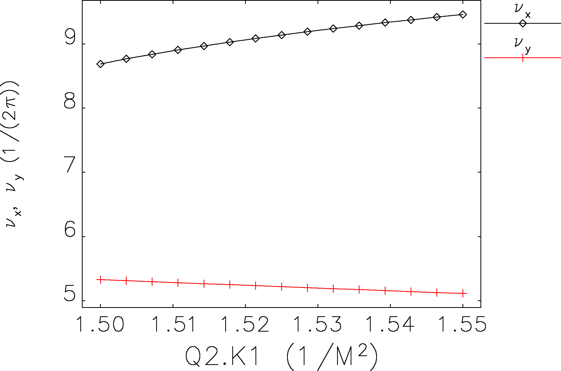

Thank you very much for your reply. I am almost new for the Elegant. I want to ask one more question. I am varying the strength of the quadruple using vary_element command and want to print the tunes with quad strengths. How can I do it. I have attached the files, in which I have tried to do so but dont know where to see the results. Please help me. Thanks in advance.

Re: tracking of longitudinal phase space
Abdurrahim,
Please see attached files for how to do this.
